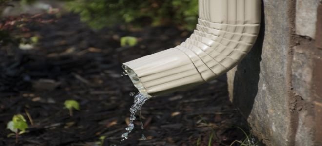

When looking at a house, you’ll see that the downspout running down from the gutters is buried into the ground. Occasionally, downspouts are fitted in such a way that simply lets the water come out of the downspout to spread into the garden with the use of an extender. However, there are many good reasons why people might bury a downspout. Read on to learn about how burying a downspout can increase the look of a home, outdoor safety and the function of the draining system.

The main reason for burying the downspout is to carry the water away from the foundation. To do this, the downspout needs to be angled slightly away from the house. In areas with plenty of rainfall, it could empty into a French drain. This is essentially a trench filled with gravel that lets the water trickle into the earth.
By keeping the downspout emptying into a trench that carries it from the foundation, you’re keeping the house much safer as it reduces the risk of the foundation weakening. This system also has the added green benefit of returning the water to the ground. Not burying the downspout or installing a system that will disperse the water will allow it to pool around the foundation and this can eventually cause problems, especially in very damp climates with high rainfall.
However, the downspout does need to be buried properly, around 18 inches below the ground, to put it below the frost line. It should run into a sloping trench with a depth of 30 inches at the far end. The trench also needs to be 15 inches wide. This will allow for the proper run-off of water.
