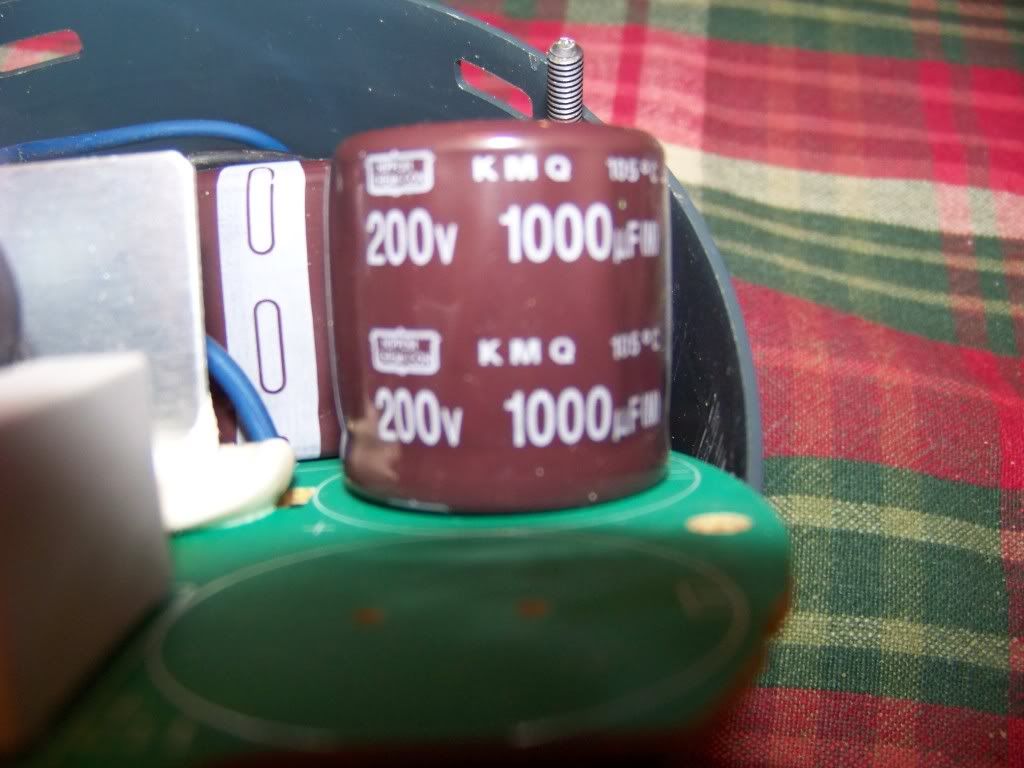

Dan,
I can repair the modules. But i would like to see a picture to know what the damage isfor myself. It may be damaged on the control board too, which is also repairable but takes some work.
It's a shame what has happened to electronics repair industry. All that is left are tech's who follow line by line repair manuals. If it is not in the manual then they can't fix it. 25 years ago an electronic repair tech understood how a device operated by tracing circuits. Not so anymore. It's all about $$$
If it's just a cap or passive component on the power supply i could fix it for $10 + parts, you pay shipping.
I'm not fond of fixing the controller under the "goop" though it can be done. This is why i've been working on a general purpose ECM controller. A good HVAC tech should be able to set up the ramp up/down, and CFM for each mode (heat,cool,fan, dehumid, etc)

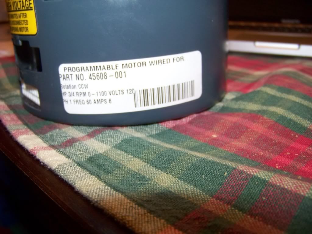

Ok so I know this thread is kinda old but I've been having some problems with my GE ECM 2.3 3/4 hp motor in my air handler unit. The unit is a Trane TWE049E13FB2. An outdated one at that. Motor intermittently turns CW an inch or two then tries to turn CCW another inch or two. Repairman said it could be the module or motor and/or recommended we get a new a/c system. Quoted the module at $1000. I do not have money that. Took the module out to look at the thermistor this morning since a lot of people have had trouble with that but no signs of a charred or burnt thermistor. Any advice?

Yes , Direction does matter, but it is programmable on this 2.3 motor. I'd see if there is tech support @

Your motor was obviously overheated and the termal protector failed to cut off the power supply to the motor.
I am curious to know what the black potting material they use for this board. I want to buy some so that I could re-pot the board after I repair the board myself.

I'd guess that the connector was lose. Sometimes the sealing pour interfers with the latching of the connector. It gets lose, resistance goes high, it heats oftens drawing the solder up the pins(if you tear it down you may see the solder-wicking action)
edkrone -
i don't know exactly what they use for potting. I personally use liquid tape or plastic dip- plastic dip is basically thinned down liquid tape.
You will find that the plastic dip favors the qualities of plastic more so than rubber, but it works.

Guys,
I am a newbie and I have been browsing around for the past couple of days. It seems I have the same problem. I have a furnace with one of these variable speed blower motors.
It is a GE unit 3/4HP with ECM 2.3
My story is this. I paid $69 for local service techs to come to my house and tell me what I already knew (blower motor not working). Ok, not that big of a deal, and you have to pay for confirmation sometimes so you can make a good decision.
Well, this was last Friday and it was one of the coldest days in NC this year and we also had a little "snow" storm. Ironically the blower quit on this cold day when I imagine the demand was spiked. Well, they said they needed to replace the motor, but because it was rare, it wouldn't be until Monday until they could get one. Today, I called the service company and they priced out what I need and quoted me roughly $850 to complete the chore parts and labor. I was shocked! I mentioned that my house was only 2 years old and that I had actually paid about $1,500 more for my particular furnace unit because it was top of the line. She said she would get back to me. Well, she called back and said that my motor is covered under the manufacturers warranty and I was relieved! However, she then said my new total was $560 to procure the part and then install! Now, I am thinking I am being ripped off. I was cordial, but I said that I was going to have to call around. When I got off the phone with her, I went up to my unit and pulled the blower unit out in about 15 minutes and then proceeded to disconnect the module. Having looked on google and seeing images, I confirmed what I was seeing as common failure mode. I then called back the company asking for an explanation of what the $560 was for if the motor unit was free. She proceeded to tell me that it covers PO for the part (office paperwork) as well as book time for the service call. I asked how much time did the book call for and she looked it up and said 3.5 hours. I did not tell her that I had pulled the part in 20 minutes and I took my time. She then proceeded to explain the time. She said that it alloted time for the technicians to drive to the local distributor and pick up the part and then to drive back to my residence and install it and then drive back to the shop. I asked if it also called for 2 technicians, and she said "no", only 1. I am a bit emotional, but stayed very professional and she was very nice. We ended the conversation with her telling me that she would call the manufacturer of the part and see if they will cover any of the labor portion of the replacement.
Now, I am an engineer, but I was the chemical type. I have spent some time on this site and general google returns, but I am not sure what the "thermister" part looks like. I can read all the numbers on my board, but do not see the number mentioned above. Also, my burn marks look to be under the leads of the thin black round thing and not the square white rectangle thing. Also, I have slight blackening under what I believe is a capacitor on the board (the big round cylindrical thing).
My gas logs are struggling to keep up, any advice on what I should try? Should I post some pictures?

Here are some pictures of my issue described below.
Here is my particular module:
Here are my burn locations:
and
and this is the one under the capacitor (I think it is a capacitor)
In the first 2 pics, the burn marks are under this round thing
The other burn mark is under this cylindrical capacitor
Thanks for your help.

Well, I figured out what the thermistor is and after more thorough reading of this post, I went ahead and ordered 2 of them from http://www.newark.com. Here is a picture of the thermistor for the novices such as myself.
http://www.newark.com/productimages/...rd/4533515.jpg
I sure hope this works.

Good news, the motor is working! Thanks to this thread and google, I mustered up the courage to jumper across the thermistor and viola! The new thermistors should be here on Christmas Eve, so I will do a proper fix when they arrive.
It started out at $850, then to $560, and in the end it will have cost around $15! Thanks for all the knowledgeable people who have covered this issue in the past!
