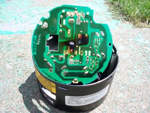

I have GE ECM programmable motor, from my furnace that has failed. The motor is:
Model 5SME39HL0307
Serial Number 0129YS
Hp 1/2 120 volt.
I have checked and a component on the motor circuit board has burned. This is the circuit board INSIDE the motor, NOT the furnace control board. It seems to be either a varistor or a thermistor. The component is too charred to get any numbers off of.
I am wondering if anyone can tell me where I might find out what type and value this component is? A new motor is $400, and the part to repair this one, is probably a couple $$.
The location of the component on the circuit board is RT01
thanks in advance.

I am sure this note too late. You may have already bhought the complete assembly or just the module.
This note is for DIYers in teh future that stumble on this note.
The Thermister you are looking for is SG348. Mine charred out too just like your. Looks like they last about 5 yeears.
I basically jumped it (pulled out the charred components and soldered the feet with a soldering iron I got from Walmart.). The fan came on and I am waiting to find the part on the internet.
There is another posting that mentions usinf a 1ohm 20-30 amp Thermister.
At $250-300 for a module or $500 for a complete assembly, someone needs to open up a repair sho for these babaies. Maybe I will

Ok so I called RTI Electronics who manufactured that part for GE. He was very nice and said that they spec'd that out for GE as a 1 OHM 16A NTC Thermistor. He cross-referenced with parts that they still make and said these two would be the same:
SG100
SG301
So there you go...easily can be cross-referenced at digi-keys. Its a $10 or so part. Don't pay $100 to amazingkeys.com...thats a huge markup! Funny thing is, if amazingkeys.com had that part for $50 I probably wouldn't have gone through all the trouble to find a cheaper alternative. Greed.

Digikeys does have the part. All it is is a 1ohm 20A NTC thermistor. I ordered 2 of them and they got to me in 2 days for $25 total. I now have a spare in case it happens again.
The Digikeys part# is: 615-1046-ND
I have had it in for a month now with zero problems.

Old 05-18-09, 10:03 AM
Join Date: May 2009
Location: pennsylvania
Posts: 22
Here are some pictures.
The modules do not always fail the same way. i've seen rectifiers blow, fusable traces blow, driver IGBT's blow, etc.but for the DIYer this is best bet.
I have tested a 3/4 HP and a 1HP motor. They were both identical electrically, typically they showed 4.5 - 4.7 ohms between each phase. These are nothing more than big 3 phase stepper motors. There are slight differences between 3/4HP and 1HP modules. 1HP module has two more storage capacitors, a larger bridge rectifier with larger heat sink, a high current NTC thermistor and thicker fusable trace. I tore down the microprocessor controls too. Both used the same IGBT with same heat sink. The PCB revision and lot codes are the same for the 3/4HP and 1 HP. The electronic components are equivilant as well.
There are differences on the older ECM modules. These modules were constructed with cast aluminum where the later modules use drawn metal housing. The older modules only differed in the physical size of the IGBT heat sink when comparing 3/4 HP and 1 HP modules.
Through experiments it is my opinion that 3/4 HP and 1HP motors are identical. The difference is in the module power supply and program.
With this said it is very likely that the two motors(3/4HP-1HP) are created by the manufacturer as one. Likewise the modules be the same untill final assembly where 3/4HP or 1HP power supplies be fitted to complete the module and place a HP rating. Either a 3/4HP or 1HP module is purchased and then field programmed for the particular application. The fully assembled motor with programming are then sold with very specific part numbers at a great markup in cost. Then a HVAC house buys the motor or module. The HVAC tech has no control over programming, or the middle men. The result? Outrageous prices for blower motor repair. Of course these are my deductions based on electronic experiments,common engineering models and business practices.
In other words. There are 3/4HP and 1HP modules. Each module has custom programming to fit a particular application.
What we need is a low cost programmer in order to use modules in other applications.

Posts: 22
Just in case someone is looking for more ge ecm module images.
Pictures by iteration69 - Photobucket
If anyone has any bad modules they would like to donate for the greater cause, let me know.

ponchopete
Take a photo of both sides of the power board(the one with the thermistor and diodes) Make sure the solder side is in good light and good focus.
If you are not certain the problem is a capacitor don't waste your time.The modules can fail in many other ways that are not obvious untill the coating is removed.
On a side note I found a way to reprogram the modules. So i've been tinkering with a field programmable module. This would allow a tech to replace the module by simple entering the code on the side of the module into the field module. The field module would ramp up and ramp down just like the original would have. It will also have the same CFM for fan, cool, heat, dehmid, etc.
Not sure if this is something most techs would like to have or not. But i know of a few who would like it, thus my motivation.
