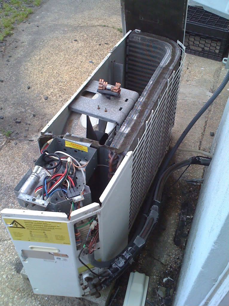

. . . thats the wiring on the top panel. where the capacitors are. Please correct me if im wrong, is the fan capacitor the top silver cylinder with brown n white wires connected to it? and is the run capacitor the bigger one below it? please im sorry if im using the wrong terminology too please inform/correct me at anytime. I totally appreciate the time and knowledge you guys have here.

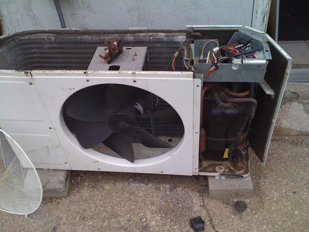

. . . . this is the view of the outside unit
. . . top view

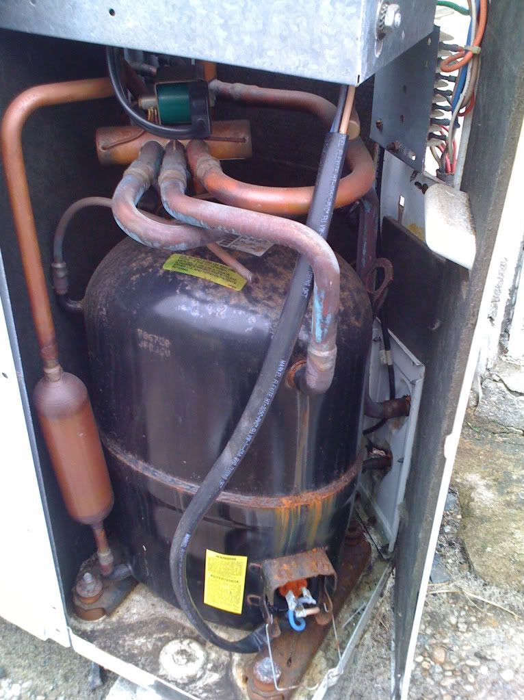

. . . . and this is the compressor.
Ok when i went out to see what happens the fan will slow down very minimal for a couple of minutes and then the compressor and fan and outside whole unit will shut off at the same time. The compressor actually sounds like its working and fine now its just it shuts off for some reason. And can i just pick up a compressor capacitor at the hvac supply store where i got this hard start kit??

HI
the capacitor that i have circled apperes to be bulging at the top (bad). that big one in the back appears to be bad also to be honest with you. did you replace any of those 2.
