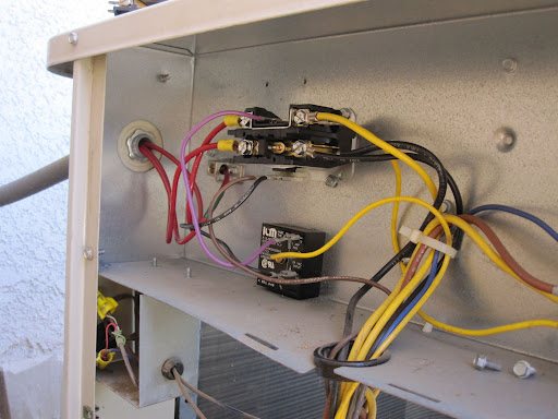

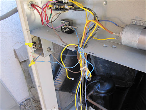

My fan just turns off after a minute of use then it doesn't come on after that. The fans are running fine to circulate air in the house but the fan on the condenser outside just stops working.

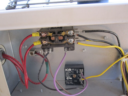

A friend of mine suggested the thermostat was bad. So we replaced it. Then he said the contactor isn't working properly. So I replaced that too. The AC fired up and the fan started working but only for a minute and now it won't start up again. The LED status light blinks really fast and does not blink a number code. I took pictures of all the wires as I changed out the contactor so I can't understand what's going on really.
Could the starter relay be the next thing to replace? I'm assuming the little black box under the contactor is the starter relay. Any suggestions would be appreciated.
Here are some pictures:
The original contactor before I touched it:
The new contactor installed:
I kept the black wire on the contactor lined up with the actual contact plate that goes up and down.

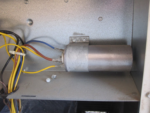

Thanks DJ. Yeah it shouldn't cost much for a new one of those... I'll go get one right now. I'll post back with an update.
Here is the original one... years later it still looks good but I'm sure it could just as easily be bad on the inside.

I should have mentioned this before. On the capacitor you'll find 2 ratings, uf [or might be mfd] and vac. Your's is a dual capacitor so you'll see something like 35/5 uf 370 vac. The rules:
1. uf- equal to what you have now.
2. vac- equal to or greater but not lower than what you have now.
