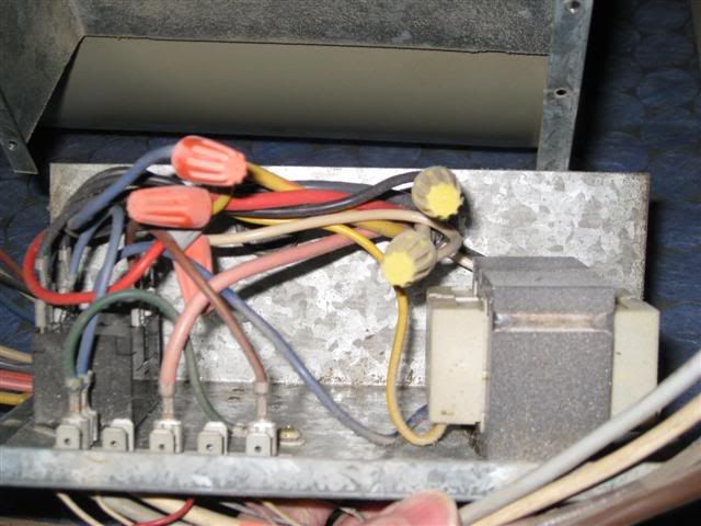

Is the picture below the secondary transformer? It measures 22V across. Is the primary transformer on the controller board?
However, there is still no voltage when measuring across R and C wires.
The link below is my White Rodgers controller board:
http://www.white-rodgers.com/wrdhom/...pg0278_281.pdf
When measuring across TH & TR of the control module, it does not have any voltage reading. L1 and TH measures about 125Vac.
Please advise where to go from here. Thanks.

That is the transformer for your doorbell.
The furnace transformer is behind that furnace control board.
(Near the blower)
Zoom out some with your camera and post a bigger picture for better assistance.

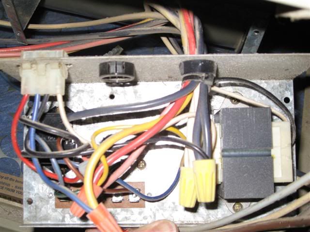

zoom out pictures of furnace are below:

The transformer is inside of the electrical box mounted in front of your blower. C and R on that terminal block connect to it.

Should be behind this the silver cover when the t-stat wires meet up.
Did you make sure you pressed the cover switch (top left) when you tried taking a reading?
The photo above, I don't like the ideal of the gas flex line going into the metal hole..... it's waiting for the metal edge cut the gas line.....

I measured 24V across the transformer on the right side (with the cover switch pressed), but C and R terminal still has no voltage. With the transformer working, how come there's no reading across C and R?
What is the black box on the left side?
Where should I go from here?

Block on the left? Looks like it's a fan relay for your fan to run in "ON" mode when you switch the t-stat to "ON".
Make sure the wire from the transformer is in place on the strip/terminal on the back side of the cover where the R and C t-stat wire hook up is.

The secondary voltage measured zero from the transformer, so that is why I am not picking up power across R & C. I measured the wrong wire from the transformer the night before...
Will stop by local hardware store to get a replacement transformer to try.
