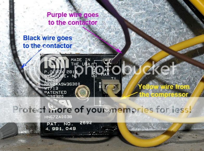

Okay, can someone confirm if the following device is a time delay as Muggle as suggested?
If it is, I wonder if this is the device that's gone wrong. The reason I suspect this device is that if I turned off the thermostat for sometime and then restart it again (doing this several time) will actually get the contactor to pull in. Sometimes if the thermostat is left running for several hours, it may also actually triggered the contactor to pull in.
  #50
Old 08-02-10, 02:55 PM
Join Date: Jul 2010
Posts: 890
Okay, I found the ICM time delay but the problem is, this new time delay does not have three tabs for connecting my three wires (yellow from compressor, black and purple). How do I install this time delay with my three wires?

Yes, time delays are what ICM makes. Call ICM Controls and ask them what the correct replacement is for yours.

Okay, here's my measurement.
All the wires (blue and yellow) that's connected to the red wire from the thermostat never managed to pull the contactor. Does this mean the red wire has problem or the transformer is low in outputting enough amp to pull the contactor?

You are right. I was checking the replacement part for the time delay and it's over $134. So, I'm going to hold off to that especially when I measure the amp last night the most I got was .216A only.
Here's how I did it.
1. I put the positive (red lead) to the red wire and the negative (black lead) to to the blue wire and I got .046A and the contactor never pulled in.
2. Positive lead clip to brown wire (which is directly connected to the white wire) and negative lead clip to the contactor. The meter reads .046A when the conactor is not pulled in. Once the contactor is pulled, the meter reads .216A.
3. Positive lead clip to the purple wire and negative lead clip to the contactor terminal. When the contactor is not pulled, the meter reads zero but when the contactor is pulled in, the meter reads .216A.
4. Positive lead clip to the yellow wire and negative lead clip to the middle time delay terminal. The meter reads .046A and the contactor never pulled in.
Okay, so your last question is, put the positive lead clip to the red wire and the negative lead clip to the purple wire (on the end that connects to the contactor terminal), correct? If so, I'll try to do that tonight to measure out. If this still measures .0416A or .216A then that means the transformer is not out putting enough amp, correct?

I see what you did. looks like all you need is .216a to pull the contactor. a little low, but hey, it works. But how do you control the pull or not-pull, if you can make it pull all the time, you are done. what you need to find out is why or what make it not-pull when the T-stat call for it. Find out if you still have 26V on the contactor when not pull or amp=0, if not, then there is an open circuit. I asked you to connect the red and purple (with or without the meter in between) just to eliminate the possibility that timer/compressor was in the way). That 0.046 is a bit strange, there is either a tiny leak or tiny consumption somewhere, but it is so small, let's hope that is not a real problem.

When amp=0, there is either no power at all or the wire is broken(open) somewhere. that is why I asked you to check the Volts to see if the power is even there first.
What I don't understand is you said 'once the contactor pulls, the amp=0216a. But how do you make it pull ? Did you turn your T-stat on and off to do this test ? or leave it on(call for A/C) all the time. The question is, when T-stat call for A/C, the contactor should pull, if not, that is the time you check the volt and amp. (time delay may complicate the issue, but it should only delay for 3 or 5 minutes) . So, turn on T-stat, if contactor pulls, you are fine, if it does not pull, check V between brown & purple, also V between brown & black, and amp on brown wire.

Many thanks for those who contribute to this thread. I could have called a professional and pay the $50. It would have been easier and cheaper but I wanted to learn this stuff too. So that is why I'm here asking for your help so I can diagnosed it myself and buy the part. However, I can't go around start buying parts because I already found out that the contactor isn't the problem. And yes, I will buy the transformer; however, I'm still trying to figure out what type of transformer I have and where it's located in the furnace.
Clocert, to answer your question. No, I have no way of controlling when the contactor will pull or not besides turn on the T-stat. What I meant to say was, whenever I turned on the T-stat and the contactor is pulled, the amp is .216 but when it's not, the amp is .046. Does this mean the transformer is not consistent with outputting the amp and that's why the contactor is not pulled?
As in the following diagram, brown & purple is 26v and brown & black is 26v:
The amp on the black wire is also .216 when the contactor is pulled but when it's not, it's only .046 even when the T-stat is on.

Finally the drama is over. The HVAC professional drove 3 miles to my house and spent 20 minutes and told me something I knew but I wasn't sure 100% and charged me $85. I drove 20 minutes to buy a $40 time delay replacement and it has been working since then. It's been about three to four days now and it's working fine.
Many thanks for all of your help. I learned a lot but wish I could have saved the $85....but that's life I guess.

I am tempted to tape down the middle button on the contactor but do not want to damage anything....
