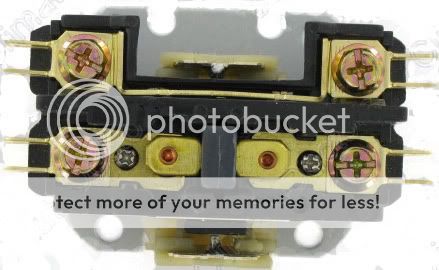

I have a Carrier TECH 2000 model 38TR030300 air conditioner that quits working last night. It was working on an off for a couple of weeks now and until last night, it never starts up again.
In picture above, I found that I use a stick to push that little thing (not what it calls) to go in then the air condition works fine. So, my question is, do I just replace that whole thing? Or, is there some other problem that causes this thing to not pushed in and locked it there until the air inside the house reaches the temperature set on the thermostat? It's going to be very hot day today. Any suggestion/help is much appreciated.

the contactor isnt pulled in huh, well the thermostat sends 24 volts to the contactor to pull it in. but the 24 volts can go to a safety switch before going outside so i say check that your condensate pump, little box on floor next to furnace to see if its filled with water. if you have a condensate pump. you can also check to see if your getting 24 volts to the sides of the contactor, not the big wires, and if you are then the contactor needs replacing.

The contactor uses a 24v coil to create a magnet that pulls the contactor in. Then the contactor passes 240v through it. Before you replace the contactor, verify that there is in fact 24v on either side of it (not at the line voltage side, but blk/brwn to purple). Replacing the contactor will do you no good if you aren't getting 24v at the contactor coil because the next one will do the same thing.

It looks very similar to this one?
Right now the purple wire is on top and the black and brown is on the bottom.
If there is no marking on the contactor, is there a way to test with a multimeter to determine if it is rated for 24v?

That is the correct wiring. Set your meter to measure AC voltage and make sure you have 24 volts between the purple and brown wire when the thermostat is calling for cool but the contactor is not pulled in. Be careful of the 240 volt wires on the contactor. The ratings for the contactor should be printed on it. Maybe on the bottom. If not then they will be on the box it came in.

As shown in this diagram, the brown and purple wire does have 26v.

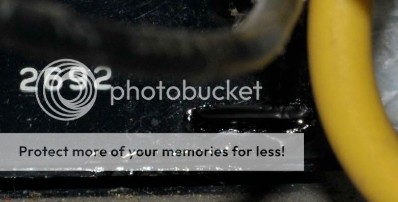

Okay, here's how I wired the new contactor.
Let me know if it's incorrect. And, will someone tell me what is this thing called and do?
Could this be the problem? On a closer look, I saw this on the bottom right corner. Does this look normal?
I have checked the transformer and I believed this transformer is part of the furnace, correct? If so, it's quite new. I just got a brand Train furnace about two years ago.
That appears to be a time delay to prevent the compressor from short cycling.

Originally Posted by clocert View Post
The how-to and the Youtube are both using the regular multimeter, they connect the wires in series (let the current go through the meter), not parallel. By using this type of meter, you have to mess around (cut in the circuit) with the wires. those are 120v and 240V, be careful. What I suggested is a different type of meter (a meter with a clamp/jaw on the top) which is much easier to use (you don't have to play with the wires). Google 'clamp ammeter', you will see them. If you want to use the regular multimeter, make sure you know how to connect those wires in series circuit, if you don't connect them right, you will get a big spark, and it will damage your meter.
The two wires (red and white) from the thermostat is only 26v not 120v or 240v. I already measured those two wires. I just don't know how much amp it has.
