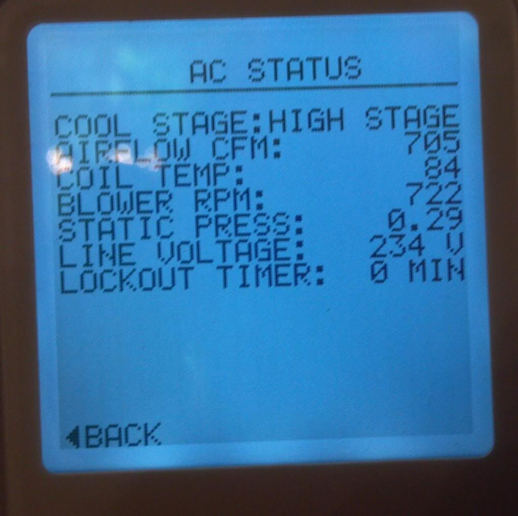

The ECM 2.3 is an impressive motor. It can use back EMF to calculate cfm output fairly accurately. The limitation is in that furnace board.
Carrier uses this information to display RPM, CFM and static pressure at the stat...
Trane is a great product. They also offer a communicating system.
#22
That's a nice display. So basically what it's doing is comparing the current that it's drawing in order to maintain a specific RPM to a preprogrammed table of current draw at specific CFM/SP levels to determine those values. It's not sensing the actual airflow..
