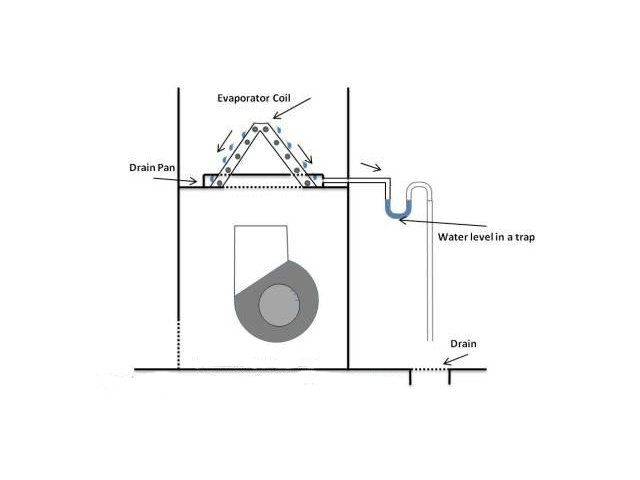

Because of being downstream the pressure in the duct will definitely cause water to blow out of the open drain ends.
You have an improper installation.
That slight curve in the main drain should be much more pronounced.
The air pressure in the duct where the drain exits the cabinet could be under a couple of inches of static pressure.
The measurement of inches air pressure is actually inches of water column and is a convenient measurement to helping you fix this problem.
The main drain line has to be removed and reinstalled so that the trap in the line is deeper than the static pressure in the duct.
IOW if you have a trap that is four inches deep and your cabinet has 2 inches of static pressure the water will not blow out the opening.
Also, the only open vent that you should have on your drain line must be after the trap.
Any openings before the trap will blow water and prevent it from going down the drain.
I would suggest at least four inches of trap depth.

Ok
The primary drain which is labelled correctly in your diagram needs a trap as in the pic above.
4" in depth SHOULD be enough.
Just make sure that the pipe that exits the trap is below the line that enters it and be sure to allow 4" of water depth.
IOW if your pipe that exits the trap is 1" below the entering drain line, the first drop should be about 6' deep.
The purpose of the secondary drain which is mislabeled on your diagram and is the open stub beside the primary is so that you can pipe it to a visible location to be able to see if your drain is blocked.
If you are going to pipe this to the emergency pan then just remove this pipe and plug the hole.
The emergency pan does not need a trap.
Once you are done you will need to make sure that once the trap is full of water that it is able to drain without passing air through the water column.
If it does pass through the 4" depth of water than you have other problems.
There is a way to simply measure the static pressure if you wanted to go to the trouble.
Turn off the air handler and temporarily plug the primary drain so no air can escape and connect a clear hose to the secondary drain,seal the connection with tape and leave the hose end open.
Tape the clear hose to the side of the air handler so that you drop down from the secondary drain and back up so there is at least an 8" trap formed in the loop and the end of the hose is well above the trap.
Then add water to the clear trap so that you have water sitting to a depth of 8" or so.
Use a marker to indicate the height of water in the tube and then turn on the air handler.
Once the water finds a new level with the fan running mark the water level.
The difference in height is the static pressure in inches of water column ("wc) and what you use to determine your trap depth.
The trap should be at least 1" deeper than the static pressure.
or, just make it 4" and you should be ok.
