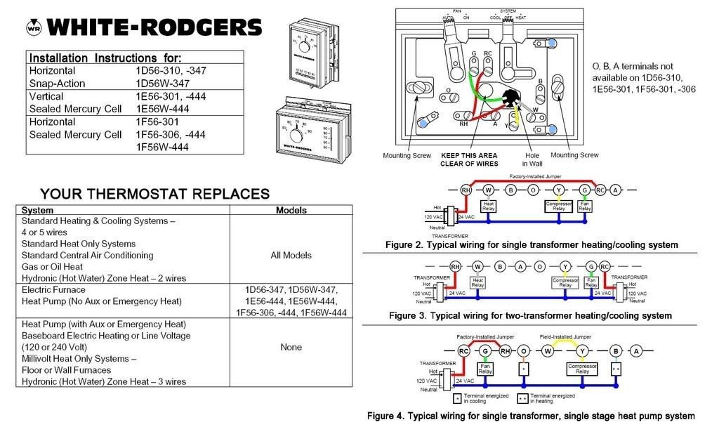

Checking the stat is a good place to start...
After removing the thermostat cover you should see 3 screws above the locations that I have highlighted blue. You have a vertical model but it appears to use the same subbase turned on its side.
If you are lucky the problem may only be dust between the small ball bearings and the contacts that they touch as you move the switches from Cool to Off and Heat.
I sometimes just blow out the dust and clean with a small dry paint brush to correct this.
If this fails to correct the problem, you can temporarily bypass the stat to prove operation of the equipment.
Take a picture of your wiring before removing any wires...
RC and Rh (sometimes just R) is 24 volt power. G is fan. Y is cooling and W is heat.
You can touch the R wire to the G wire to bypass the stat and run the fan.
If you also add the Y wire the fan and cooling should run.
