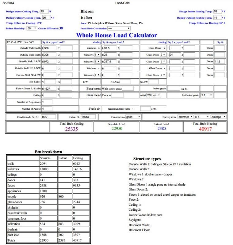

Ok, worked on the load calculator last night. And the numbers just dont add up, even close, to what the installer told me. I must be doing something wrong?
So below is the first floor only. The installer told me like 100,000 BTUs were needed, but I'm coming up with @ 20,000 BTUs.
any ideas???

Load-Calc
Outside walls sf feet NOT figured correct...not enough wall & window sf area.
Length of outside wall in feet times height in feet = sf area of that side
Windows: use height in feet times width in feet = sf area of window or door; add all the windows & doors on that side of the house and add those on East & West sides together.

Wow. Oh I figured I was doing something wrong! Ok thanks so much for clarifying that for me. No wonder!

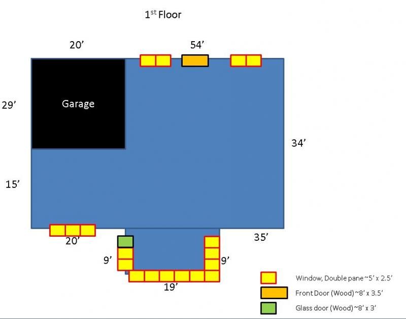

Ok, so I re-did it and the numbers look more realistic. Still not close to the 100,000 BTUs they're recommending.
Thoughts? I did this for the first floor only, where I have one complete HVAC system.
First, a crude drawing of what the floor looks like with measurements. We have 9' ceilings.
And then the load-calc using true SF for all items.
Unless I'm still doing something wrong, why would I EVER need 100,000 BTUs??

List direction of front door; front of house.
When U have it right click on Sizing link there...
It will probably be close to the same...
Using he heat load at -15F here in SW WI. It sizes heating above what the actual worst case scenarios have been the last 2-years for me!
It appears they were way oversizing for heating.

You're probably not too far off with the 40k calculation. I can't make out some of the numbers and words but I would say thats a 100 times closer to the actual load than your potential contractor.

Ok, see updated. I
1) marked out the location of the front door
2) blew up the readings a bit
3) ran the sizing report as well
I will mention that it seems like they are oversizing the system for my needs.

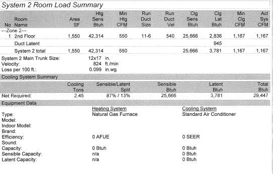

Hi all,
First have to thank everyone again for all the help here. This is a big endeavor and couldnt have done it without you.
So I received my whole house load calculation from the company doing the install. To recap, the company quoted me the following on a 95% efficient HVAC system:
- Furnace: Trane XV95 2 stage var speed furnace
- Air Conditioner: Trane XL16i 14.75 seer 12 eer 3 ton 80k btu
It seemed like the 80k btu was way too high. So with help here I did my own rough calc online (above - thanks for the help) and came up with something different. Now looking at the installer's official, detailed load calc (summary below) it seems to be inline with my estimation.
So my question still remains: are they quoting me with an oversized system?

Well the AC is oversized because they only come in full ton models, so anywhere over 2 tons and less than 3 would fall into the 3 ton category. As for the furnace, I have no clue why he's putting in an 80k furnace. The smallest one they make is 60k on high fire and thats more than enough and that has a 3 ton blower motor so it's more than sufficient.
