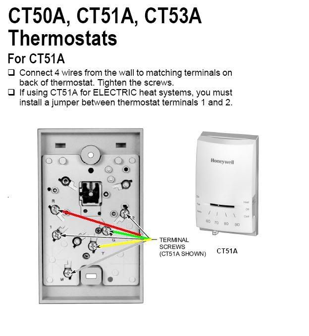

I have had to dust off the points made by a small ball bearing in older mechanical stats when they are located by the air intake and pull dust into the stat.
This example shows the top and bottom of a mechanical stat but it is the middle that I clean...
Do you have a volt meter?
Is the contactor pulled in when a demand is present at the thermostat but it does not run?
Are you getting 24 volts to the 2 field installed wire nut connections?
Does the capacitor appear swollen on top?
Any melted wires visible?
