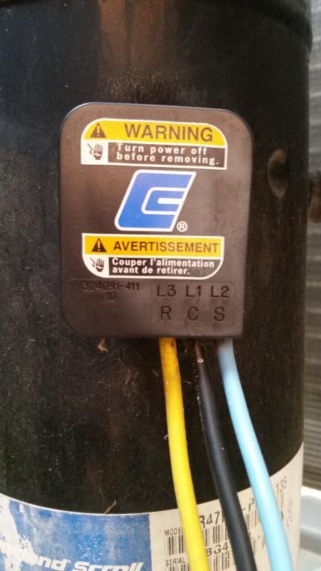

Hello, I have a central air system where everything's working except the outdoor unit's compressor will not start; the fan runs fine. Also, every few minutes it makes an electrical noise for a second or two like it's trying to start but doesn't.
Is there a short list of things that could be wrong, like:
* Low refrigerant (and thus a leak);
* Compressor locked up;
* Hard start kit needed?
I'd like to know if there is anything else to add to the list and maybe how to test. I have a voltmeter and am a DIY-er.
The system is 12 years old and I noticed that there's a capacitor with 4 wires on it. I also took photos so please follow the links for larger pictures.
I don't see any burn wires and the capacitor looks OK too.
How do I set the volt meter and where to test first?
Thank you!

It's a bit hard to tell, because the wires are in the way...but the cap should be flat across the top where the terminals are...even slightly bulged means it's probably bad.
Your disconnect looks a little tarnished, but the important part (between the prongs) isn't visible. Thats where contact is made.
The Pro's can give you specifics...but measuring between all the compressor terminals and from each to ground, then posting the info will be a help. I can't see any markings so just use 11 o'clock, 3, and 7 as descriptions.

Ohm out the compressor. R to C, S to C and R to S. Post back what you find. Set meter to far right.

OK Thank you. The cap looks flat. I did what you said and here are the results:
This is the plug to the compressor:
From the cap the voltage measurements are as follows:
Blue and Yellow respectively to ground are at 48.3 and blue spikes to 53 and yellow 51 briefly every few minutes when the noise like its trying to start is being made.

You misunderstood.... you need to measure ohms (resistance)...not voltage. And thats at the compressor terminals with power off and the connector off..like in the earlier picture.

R to C = 1.4 Ohm
S to C = .2 Ohm
R to S 1.6 Ohm

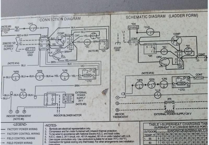

That compressor Contactor looks burned,are the points burned? Is there a legend on the Dia.to explain what some of the abbreviations are?

I would say your start winding is bad.

After doing some research, I think skaggsje is probably right. Heres a basic explanation...http://www.doityourself.com/forum/ai...-readings.html
You might also check each terminal to ground.
