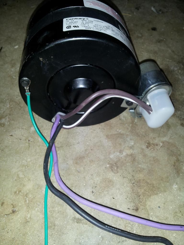

Hello All, I have a Trane XE 800 A/C unit. Model Number is TTJ724A100B0. My a/c condenser fan motor seized and I found a replacement. It is a Century OTR 4513. My old fan motor did not have a capacitor mounted on it like the new one does. My old motor is a GE 5kcp29ck4629s. The old motor has a purple wire which goes to the capactitor and a brown wire which also goes to the capacitor. The capacitor is mounted on the AC unit. The 3rd wire is black and it goes to the top of the of the AC. All was well. I received the new motor and it has the capacitor mounted on the motor itself. A brown wire and a brown/white wire go from the inside of the motor to the capacitor mounted on the motor. That leaves me with a purple wire and a black wire. I know where the black wire goes, but the purple wire, I do not know. The purple wire on the old motor went to the a/c mounted capacitor. This new purple wire can go there, but there is no brown wire for the other side of the a/c mounted capacitor. Any help would be appreciated. I will upload some photos.

Your new motor will be the 4 wire and your old motor was a 3 wire.
Your new black connects where the old black went and the new white (or yellow) connects to the brown/red wire
Old 07-26-14, 05:37 PM
Join Date: Jul 2014
Posts: 8
The new motor only has a black and purple wire. The brown and brown/white wire comes from the motor and goes directly to the capacitor mounted on the motor Itself. The old motor had black, brown and purple. I will get pics.

New Pics Houston204
Old and new. See how the brown and brown and white wire go straight to the capacitoron the new one?
I can only use 2 wires--black and purple--
New motor wiring diagram
Thiis the old one's wiring diagram

Connect your black to the location that the old black hit the contactor.
Connect your purple to the location that the small brown wire with red stripe that is on your capacitor hits the contactor.
The 2 brown wires on your new motor connect to the new cap.

From the wiring diagram on the new motor (in your picture), it looks to me like the black and purple wires on the new motor connect to exactly the same locations that the black & purple wires on the old motor connected to. The capacitor is pre-wired to the new motor, so all you should need to do is connect the black & purple wires.
Old 07-27-14, 07:49 AM
Join Date: Jul 2014
Posts: 8
Bob14525--Thank you Sir..that did it. We have ac again..I appriciate it more than you will ever know.
