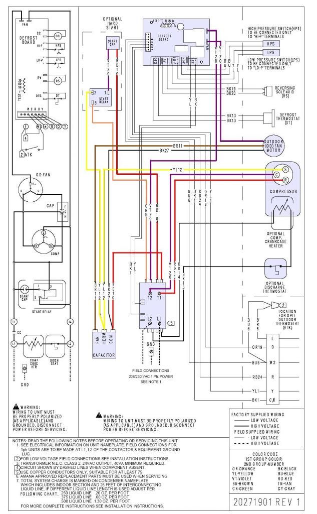

Below is the wiring of the old contractor. I basically got a new contactor and replaced it the same way though the new on doesn't have labeling.

There is no neutral on that 230 volt unit.
Connect terminal 1 to Run (which is C on a dual capacitor if you have one).
Connect 2 to Start (which is Herm on a dual cap)
Connect 5 to Common (which is the leg of power that isn't connected to the dual cap Com terminal)

http://johnstonesupply9.com/TechDocs...ECH%20INFO.pdf
Refer to page 35.
The start relay 5 lands on purple not red.
Your clamp meter grabs the purple wire to the compressor.
I never install the 5-2-1 brand start kit. The relay is slow to take the start cap out of the circuit so they have a very short life, often only around 1 year. The Carrier P296-011 start kits that I install last many years. 1 connects to the start cap and leaves the start cap to connect to Run on the 011 as shown in your diagram. (It actually also does this with the 5-2-1 but I think that part may come prewired).
The 5-2-1 is a good price. I saw an outrages listing for the p296-0011. I don't pay much for the 0011.
I would look into the factory recommended start kit for that unit.
Refer to page 35.

when you say purple, did you mean violet (VT) as labeled by the diagram?
when I look at the diagram, I saw both T1 T2 lead to the compressor. T2 (VT20) leads C and T1 (RD10) leads to R. what's the difference? Why do we measure amps on T2 but not T1?
The diagram actually used 5 2 1 labeling for optional hard-start. is that a generic naming for hard start (rather than branding)?
You inspired me to read the diagram (which I didn't dare to do).

1 goes to the start cap then to run.
2 goes to start.
5 goes to common.
And odd fact that causes confusion is that Run is labeled Com on the dual cap. That terminal is common to Herm and Fan on the cap but it is Run on the motor circuits.
