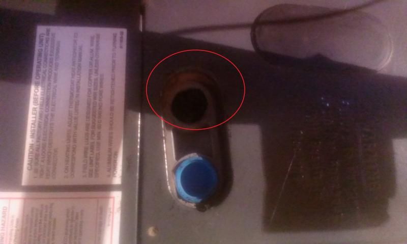

EDIT: One other thing....I don't hear any swishing noise in the area of the air handler circled. I usually hear some noise (presumably vacuum) in this area and fee cold air but now I feel nothing.
Not sure if this helps. (I believe that there is supposed to be a cap in there...but it came without one when I bought the house back in '07) so I filled it with some tar for use in an automotive application. (Don't worry I didn't drop anything in there).

Is that the unit with the motor that spins? If so, yes the fan is spinning. Sorry I didn't mention that. Would air still flow from the registers for that part? There is a black plate on the air handler that has a picture of a box cutter engraved on to it, but I don't want to cut it and have to replace another plate if I am wrong about there being a breaker under that.

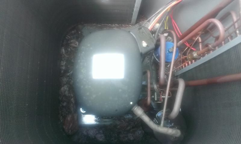

Here is a pic of what I am looking at:
Any ideas?

That's your compressor. It's most likely not running. The capacitor(s) for your system are in the wiring access box in one corner of the condensor. Check the corner where the main wiring enters. Make sure main power is off first.
Ok, I found the capacitor. Any thoughts on what to do next?
EDIT: As I was looking at the Capacitor. I could hear a buzzing from the transformer near it. As I simply observed it all without touching anything, the fan stopped blowing and now the top of the casing that the fan bolts to is hot.
EDIT 2: I sprayed the fan motor down with cold water and it started blowing cold again.....but cold air still not coming out of vents as far as I know.
EDIT 3: Also, I moved the fan with a stick and it started moving on it's own. That seems to be a way to check for a bad capacitor. Even if the fan capacitor (seems to be called a start capacitor) is bad, can that stop the compressor from firing up?

The buzzing you heard was coming from the 24vac contactor that starts the condensor running. Since that contactor was humming and the fan was trying to start.... the power companies smart box was not active.
You may have a bad fan motor or capacitor. It's an inexpensive test/repair to just replace the capacitor(s). The compressor won't run for very long if the fan isn't running. It may have been off on overheat.

Replaced cap and all is well. Capacitor was not holding any voltage. No physical failure either.
