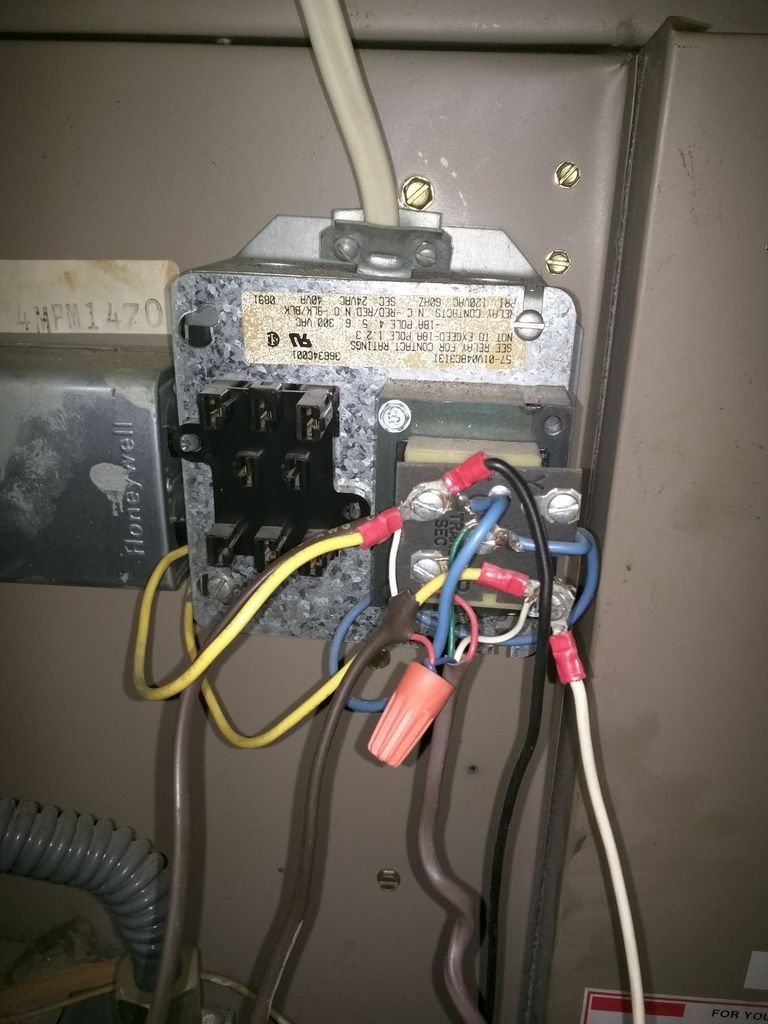

Ok, I used photobucket this time... hopefully it works better
Here is the unit type
Opening the panel I notice this yellow wire not connected to anything and just sort of stuffed in there:
Here is the wiring to the back of the relay plug:
And here is an overall view of all the wires. I tried to split it apart enough to allow all of the wires to be viewed:
As you can see, the relay plug is lacking wires at terminal 3 and 5. The yellow wire that is not connected to anything is possibly the yellow wire referenced on the sheet of paper the tech left with me?
Let me know if I need to take more pics of the wires. I notice some of hem towards the back are still difficult to see properly (or at least to follow where they are going in these pictures).

There should be a wiring diagram glued to the inside of the door on the blower compartment.
If that is the same fan/limit control Armstrong used on thier oil fired furnaces, those two yellow wires apply a current to the fan/limit on a call for heat. The purpose is to bring the fan on sooner than it would normally come on due to heat from the flame. Since you run your fan all the time, it's a moot point. You can leave them disconnected.

With that relay.... there are two things happening. When it is not energized it allows the fan/limit control in that gray box to control the fan, based on heat, for the furnace only.
A/C or FAN ON mode activates the relay which turns the blower on, usually on high, and disables the fan/limit switch.
This is done so that the fan/limit speed setting, which is usually medium, can't be activated the same time as the high speed A/C mode.
We'll get your wiring straightened out... I'm looking now.

I think when I opened the box I killed the blower. It is no longer running, so when I got home today the house had heated up quite fast. That errant yellow wire was likely hooked to something before, and was likely just barely hooked in.
Or, if that wasn't it, then something else came loose. Just like when the relay died, I can hear the system running and the condenser is on full blast, but no air is coming through the vents.
On your air handler..... there should be a service door. On the back of that service door is the wiring diagram.
Where do those 2 yellow wires originate from? What is the model # on that Honeywell fan control?
terminals 1-2 N/C. 4-6 N/O on the relay, the 2 blue wires from the relay base are the coil feed controlled by the Tstat.

I believe those two yellow wires are from the limit part of the fan/limit switch.
I've been looking at the wiring. It looks the heavy orange wire is connected to the black wires with a red wire nut. Remove that orange wire from that connection and reconnect it to the black wire with the yellow wire nut.
The bottom pic shows both yellow wires connected to fan center,when was it removed,or put on there?
