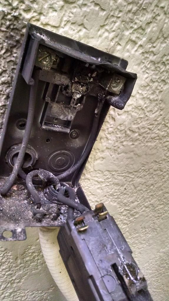

Well, I guess I have cold air again and many appreciative thanks to both of you for the invaluable advice. Apparently the problem was the circuit breaker.
I had made multiple checks in the past few days at the contactor and showed roughly 120ish volts just about everywhere. My thought originally was a bad contactor or circuit breaker but seeing as how voltage was present in a number of places I dismissed the idea.
Today however, when checking it I got 0 readings everywhere. After removing the circuit breaker I checked it with my VOM and found one side was stone dead now. So 15 dollars worth of new breaker later the unit is up and going.
Now the docs and pharmacies where we're on a first name basis get the money instead of a professional HVAC guy....... :-)
Again, the most sincere thanks for your help. It is greatly appreciated.

Just a final thank you and one additional bit of info. I drilled the rivets out of the old circuit breaker for a look inside as I'm always curious about why something fails.
On the failed side of the breaker one half of the contact points had a small lump on one edge which was apparently caused by long term arcing. Most of the point surfaces were not able to touch due to that tiny (eye of a needle size) lump. I guess that could explain a random triggering of the VOM and not enough contact surface to carry any kind of electrical load at all.
