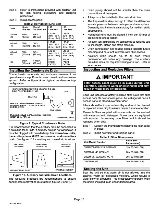

One more quick question. In the manual, this page states how to install the trap and the recommended specs:
The manual states: "It is recommended that an auxillary drain be connected to all units." Then further on: "Auxillary drain should run to an area where homeowner will notice any drainage. The auxillary drain line does not require venting or a trap". In the picture below, is the green highlighted section the area where the auxillary drain goes?
And would it be ok just to screw in a short piece (3+ in) pipe and have it just run out to the floor, so if the floor is wet there, the aux drain is working, which means the main drain is clogged?
-Pat
-Pat
Yes, that will work. better put a pan under to catch the water so your floor won't get wet. (you can still see if water is in the pan or not, or pipe the water out to somewhere you can see)
