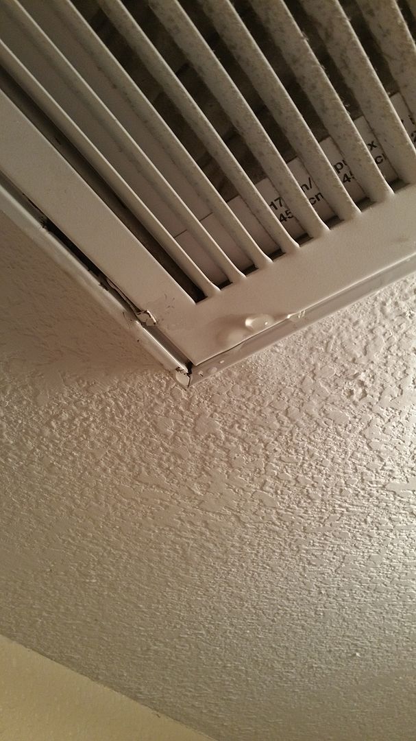

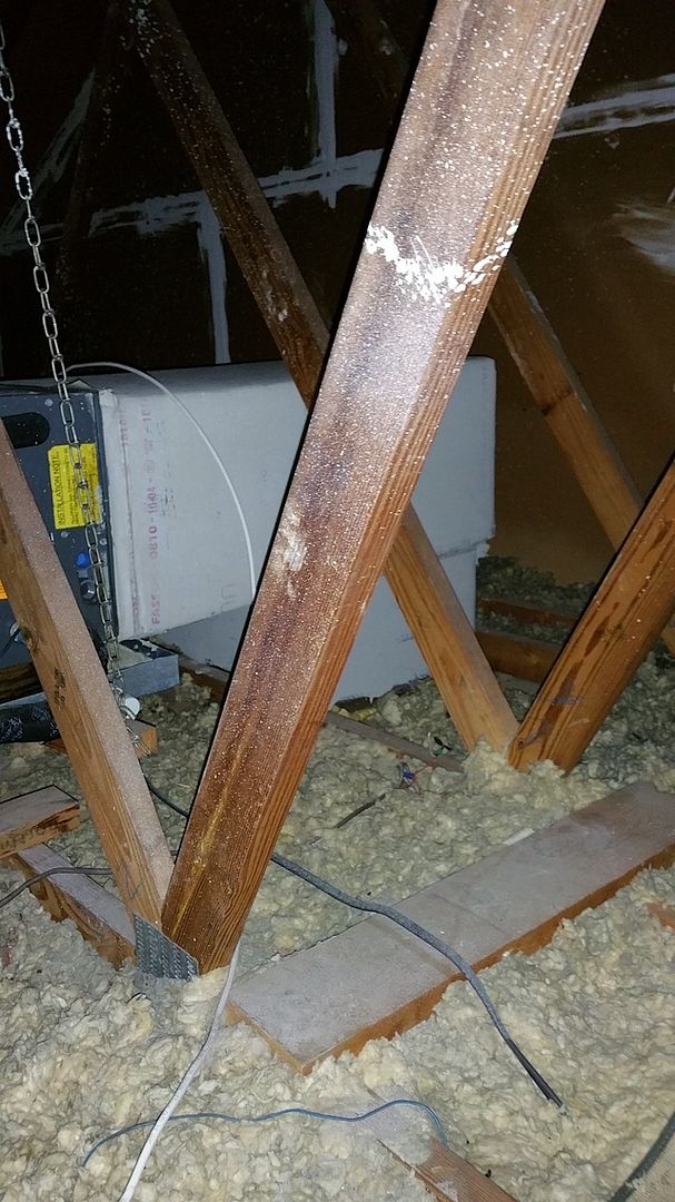

Update, went up in attic and the drip tray is dry. I did notice it seems the water does not come out of the air inflow duct until the a/c cycles off. I have taken pictures below. My (extremely uneducated about HVAC) assumption is that the coils are freezing up causing periods where the air is not cold and the. I find im shutting off the cool function for an hour ir so just running the fan. After that i set it back to cool and all is well.

Water leaking out of air intake (I assume condensation )
The grey area L shaped thing is the air intake

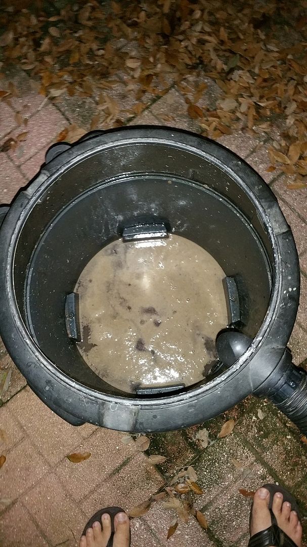

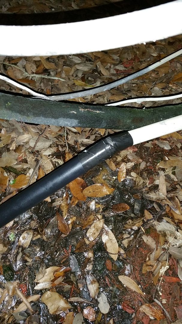

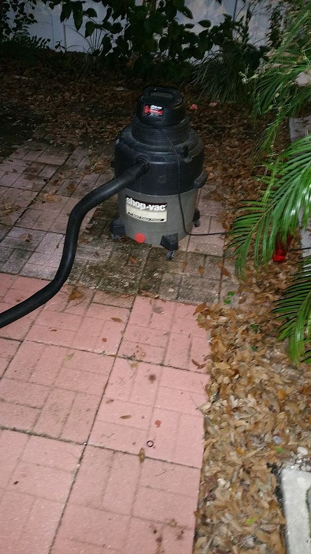

Did the Shopvac drain suck trick using Duct-tape to connect the vac to the drain line see if that makes a difference. I will be monitoring the air intake for the next day or so before I assume im out of the woods.
