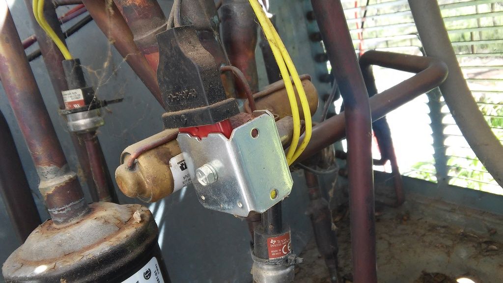

I threw a start capacitor on it for another cheap fix, still the same. I noticed a valve on the reversing valve with a two prong connector I think is very hot to the touch. The second heat pump for downstairs is cold when I touched that one. That unit works fine. And with the power off the fan runs a slow speed on the unit that won't cut on??
Old 04-20-16, 11:35 AM
N
Join Date: Nov 2014
Posts: 30
Received 0 Upvotes on 0 Posts
Here is a pic of the part that's hot to the touch. It has the shiny metal bracket with a bolt through it in the black connector on top.Its actually a magnet that clicks when you unplug and plug it back in. Very hot to the touch also.

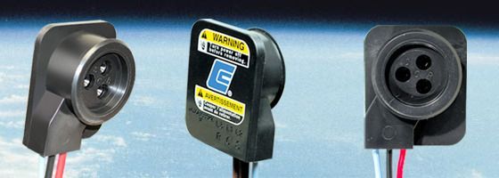

Does the plug or wire assembly just pull straight off the compressor? Its on there pretty tight i wasnt sure. Do o just pull it off or is there a trick to it?
Old 04-20-16, 08:34 PM
Houston204's Avatar
Join Date: Oct 2009
Location: Texas
Posts: 6,480
Received 90 Upvotes on 83 Posts
It comes out a little like a cork. Just wiggle it out.

Is that magnet on the reversing valve suppose to be hot? It is cool on the other heat pump that does the downstairs . You can hear a click every 30-60 seconds or so coming from the compressor it sounds like but not sure. In the winter the heat pump kept kicking out with a code telling me low pressure cutout I think. I'd reset it and it kept woring until it kicked out again. It always acts up it seems.
