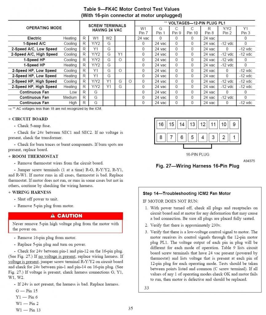

I salvaged my old 5 ton blower from a defunct system. Its from a Lennox HP21. Its a two stage, VS blower. Rather than throwing it in the trash, I was hoping to turn it into a standalone porch fan with a two speed switch. Trouble, is, while im good with electricity, im not sure how to wire it, or if its even possible. Can it be done? Lots of wires here.
Big Picture: https://goo.gl/photos/CoRhMCPcrc7kyQ78A

http://www.hvacpartsshop.com/manuals/HP21%20SERIES.pdf
An HP21 is an outdoor unit. That looks like a furnace blower motor.
You will probably need to locate a furnace manual that maps the 16 pin connector.
I have seen Geo units and Carrier units map these pins but I'm not sure that I have seen Lennox provide this information.
I have seen 12VDC to terminals 1 and 6 used to provide cooling speed on some Carrier air handlers. I have seen the numbering reversed on different manufactures.
This Carrier example put common at pin 9 instead of 1?

It'll take a little doing to come up with the pin wiring but before I spend that time.... that IS a 240vac motor.
Are you prepared to feed it with 240vac ?
hvac parts shop/manuals/CB31MV Series.pdf
Old 05-21-16, 10:41 AM
Join Date: Aug 2010
Posts: 346
See album again for pinout. It's in the manual and I took a screen shot. But it indicated it can be 120/240. I think....The sticker says it too. So....does it require 240v for certain or can it be used with 120v?

Your picture says to jumper 1 and 2 for 120VAC applications.
Old 05-21-16, 09:32 PM
Join Date: Aug 2010
Posts: 346
Hmmm....OK. The problem is that the 5-pin connector does not have any wires coming out of 1 and 2 that can be wired or 'jumpered'.
http://www.innovation-group.com.ua/d...m/ah/9618h.pdf
It says on page 9 that the jumper will be 'in the harness'. Since that's not the case here, guess that means this was set up to be a 220v for sure. But...can I just jump those to pins in the motor?
Also, I assume the black wire goes to black, ground goes to ground, and the orange goes to white?
Finally, if that is all legit, how do I get two speeds out of it? Or one for that matter. Cant see that the 16pin connector is of any use without the control board and 24v. So what now?
I added more pics to the album.

I have had continued education instructors tell me that a 9 volt battery can be used to supply the dc voltage.
1 - 6 (C and Y1) would be low speed and 1 - 14 (C and Y2 speed) would be high speed.
I would use a 12VDC transformer if I was going to attempt this.
I wouldn't need to adapt an ECM motor for a garage blower. I have thrown away many 115VAC PSC blowers and kept a couple but I would be very interested in your results should you try it.

So...is this correct?
1.) connect Pin 1 and 2 on the small connector to get 120v. Then wire up as usual, black to black, orange to white, and green to bare ground.
2.) On the 16 pin connector, jump 1 and 6 for low speed OR jump 1 and 14 for high speed.
If this is correct, then good. But where do I connect the 12v + and 12v - on the 16 pin connector?

Based on Houstons post.
Pin 1 (12v-) C and pin 6 (12v+) Y1 would be low speed
Pin 1 (12v-) C and pin 14 (12v+) Y2 would be high speed.
