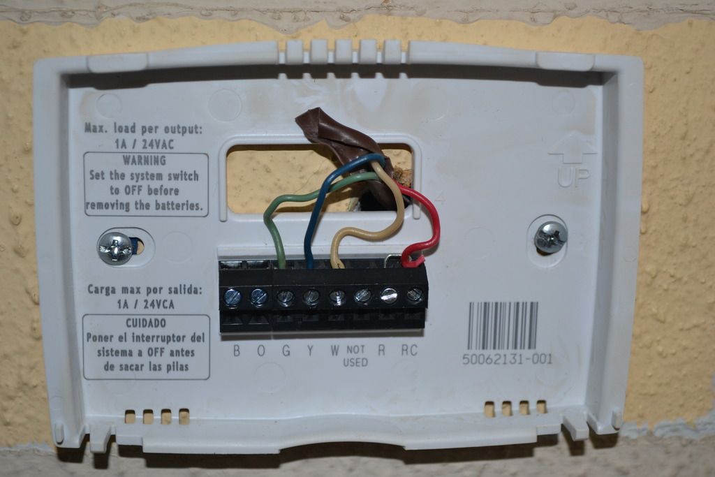

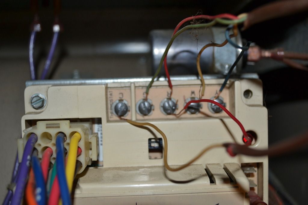

Here is how the thermostat is wired. There are two extra wires (red and white) that are wired to the control panel but do not hookup to the thermostat. Is this the correct wiring?

From your pictures, it appears that the thermostat is wired correctly. The extra white wire is Common (chassis ground), while the extra red wire is 24VAC. They are probably coming from the 24VAC transformer. The W (white) wire is the one that controls the burner. Try temporarily disconnecting the white wire from the W terminal on the furnace and see if the problem continues.

There isn't any indication of a float in the wiring pictures.
It just occurred to me why the condensor only runs one time and trips the breaker. In the picture the condensor is connected to constant 24vac. When the inside blower shuts off the compressor goes into high pressure overload. It probably cycles a few times on overload and then trips the breaker. Pretty hard on the compressor. You should have heard it cycling.
The 24vac from the transformer is not connected at the thermostat connections..... it's connected at the 12 pin plug.
That two wire cable is from the outside condensor. White on C is correct. The red is connected to R but it is supposed to be on the Y terminal with that black wire.

Pete, good catch. You're right, the "extra" white & red are the control signal cable running to the outside unit. That likely explains why the system is behaving like it is.

Ok guys, with the white wire NOT attached to W and the Red 24VAC wire attached to Y we have been running normal for a few cycles now! Should I try reattaching the White wire to W or wait until I need heat to do so. I have not had a problem with heating. I really appreciate the help you guys! You guys rock!

Pete found the problem. You can hook the white wire back to the W terminal and it should continue to work correctly. Leave the red wire connected to the Y terminal on the air handler terminal block.
