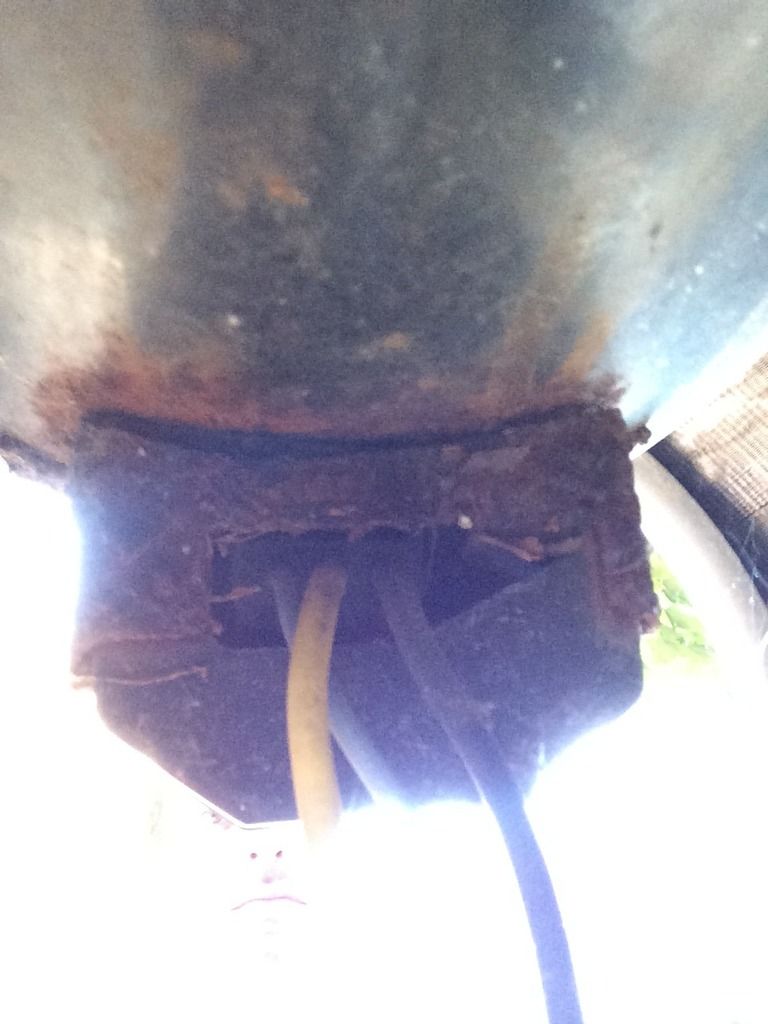

I disconnected the feed wires for the contactor (the ones at the bottom, white and black wires) and it did not trip.
Then I connected the feed wires back into the contactor and disconnected one black and one yellow wire from the contactor, the wires that connect with the screw (the front wires) and it did not trip the breaker.
So now the next step is to follow the black and yellow wire that I disconnected above (the ones that screw into contactor) and see if I can find any damage?
  #25
Old 06-16-16, 12:33 PM
Join Date: Oct 2013
Posts: 27
I followed the yellow and black wires and removed the fan bolts to look on the inside. I'm not seeing any exposed wire, I looked in particular where the wires go from the cap area to the inside where the metal is. No cut in the wire insulation or charred or anything.

Posts: 7,350
Likes Received: 6
Grounded compressor. Sounds like it is time for a new unit.
Unplug the compressor and try it again.

They normally go to the contactor coil, That looks like a 38ck048300 condenser.
Those 3 compressor wires are Herm on the cap and black and yellow using the set screws on the contactor.
I have seen a Carrier 38TDA give me that exact spark with a grounded compressor a while back. It was one a the few times that I wish I had a Meggar since it would not show me an Ohm reading to ground even when she to millions of Ohms.
A grounded compressor will usually show resistance from each terminal to ground.

I was hoping it was just the whip or some wiring, but my first thought when seeing the spark was the compressor, with slight hope for fan and faint hope for wiring...You could have fixed anything we eliminated. Now we have hit a bridge.
At least you have a better feel for how it works(or used to) now.
Compressor is probably internally grounded, and you are seeing the current go from the condenser coil(which is just like one huge wire connected to the compressor) to the ground block inside the electrical cabinet. Path of least resistance...and its purpose.

I removed the 3 wire connector from the compressor and the breaker did not trip.
Anything else I can try to check? I have a multimeter, or does this pretty much sum it up that my compressor is dead. It is CR42k6-pfv-220.
