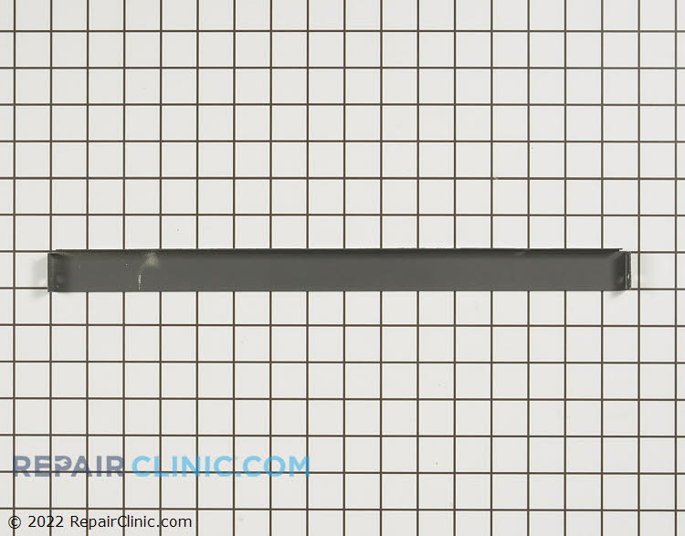

Second question. I have a filter slot for this handler but no cover. In other AC units I have used before there is usually a skinny filter cover that attaches to the body with two thumb screws. Did a search online and found a part number for the cover.
Goodman Air Handler Filter Cover 1722085PDG
But it appears this cover is not designed to go on and off every time a filter is changed, there is no thumb screws on the front. Looking at the filter slot itself there is no attachment slot for the cover in the front either. So is there a way to cover up the slot each time I changed the filter. Right now I taped over the slot with duct tape.

Sticker #2 is for the electric heating coil as it is field installed. It looks like you have the 5KW version.
Some of those filter covers are press/tension and often they don't fit right or pop off so get lost or thrown away. Lots of people use duct tape in place of the cover but please don't as it leaves a sticky mess after a while.
I see that it shows as a $3 part with $7 shipping so at least not a big risk if it doesn't work for you. Goodman does show that part number for your ARUF182416AA and I don't see any thumb screws.
