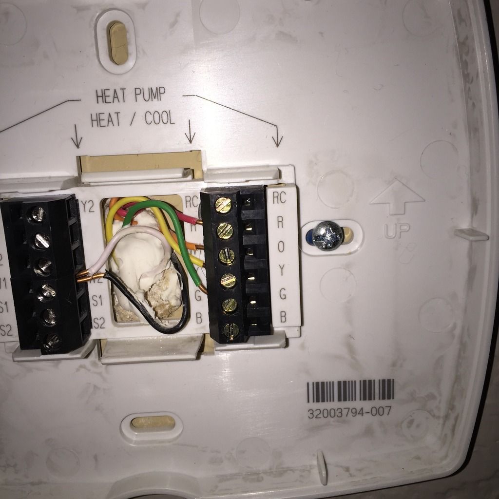

The fan and the compressor only began to work when I manually pressed down on the contactor. I was unable to get the unit to cool or heat function to work when using the thermostat. The fan as well as the compressor would not operate or even turn on.
Attached is a picture of the wiring on the thermostat.
Thanks for the problem update, it makes sense now. From your description of the problem, it could very likely be a lack of 24VAC. You'll just have to measure the voltage from R to C (at the air handler side) to determine if that's why the system isn't working.

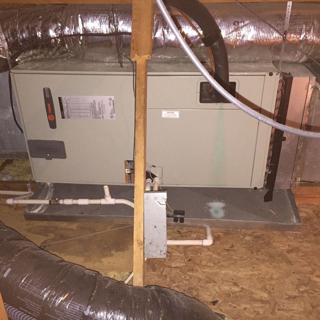

Here's a picture of the air handler. I'm assuming that breaker is the on and off switch? Just asking because I don't remember seeing another one last night anywhere close to the unit.

Look at the float switch cable. The red goes to R and the blue supplies to the red wire of the thermostat.
Remove the wirenut and touch the splice to R on the board. See if system works now.
If it does.... there's a problem with the float.
Yes. The idea of the float switch is if it's triggered it interrupts power to the stat/system.
You are basically bypassing the float switch.

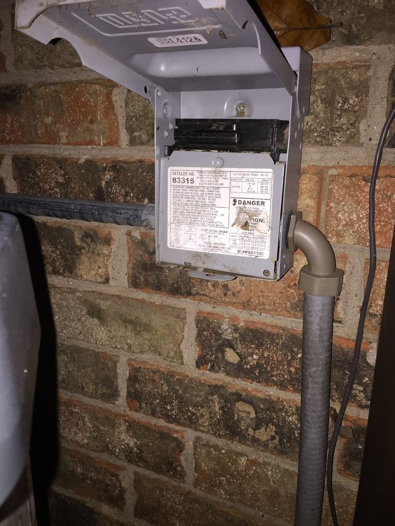

Actually got power to the air handler. The breaker on the control panel was partially tripped not sure why I didn't see it. The power to the unit came back on for 10-15 minutes and the tripped the breaker again. Determined that the breaker upstairs near the unit was receiving 40-43 and the breaker the breaker in the attic was rated at 60 and the breaker on the panel was 30. Replaced the breaker on the control panel with a higher rated breaker and so far all is well. Cycled through various cycles of and and off and it took 17 minutes to reach the correct temperature.

What do you mean by it was receiving 40-43?
You cannot increase the size of a breaker past the units maximum allowable circuit ampacity or wire size.

The unit in my attic was receiving 40-43 amps??That breaker in the attic was rated at 60 amps. I did not place this breaker there and had no knowledge of it prior to two days ago.
I've lived in my home for four years and this is the first time that I have ever had an issue with the handler. The home was built in the 80's and based on the pictures I provided I'm not sure the mfg date on the unit.
The breaker on the control panel in my garage was a 30 amp. Replaced the breaker on the control panel with a 40 amp breaker.
I did exactly what the electrician said. Is this not correct?
