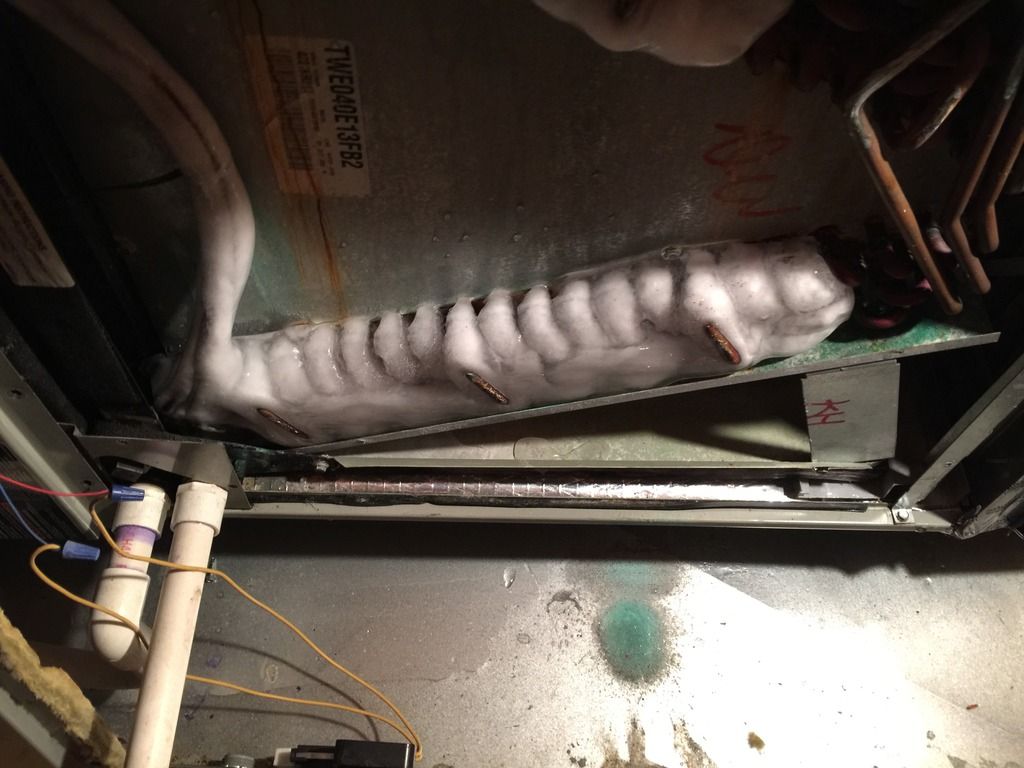

Yesterday was the first time I ever noticed water dripping from my soffit vent.
1. I first cleared condensate line. I used a shop Vac to do this it was extremely clogged. I did this in my bathroom, and both side of the p-trap. It was extremely clogged with sandy like dirt.
2. I noticed that the coils on the handler were frozen. The coils though didn't seem to be overly dirty. I also replaced the air filter about a month ago. I turned the system off and allowed them to completely de thaw.
Is there anything I can do other than to turn the system back on?
I planned to monitor it for 24 hours before calling out a pro.

There's a few things that can cause this, low air flow, system low on refrigerant. Take a tissue and tape one end to a register . Then start the unit and see what kind of air flow you get. Lets us know.

Probably a lack of refrigerant or a stuck outdoor contactor.
Does the outdoor unit turn off when you satisfy the thermostat?
( thermostat on cool mode but the setpoint is above the room temperature)

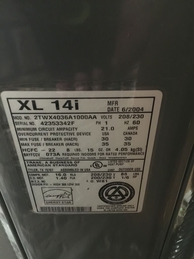

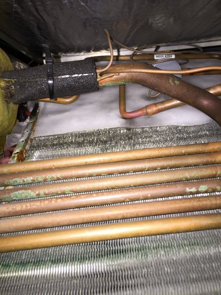

I had someone come out and they added a few lbs. I was told 5 of R-22. He told me I had a leak or bad valves based on the way that he put it in. He recommended a new system? It's a 4 ton Trane.
Any other options?
Old 05-02-17, 12:25 PM
S
Join Date: Feb 2014
Posts: 1,771
Received 0 Upvotes on 0 Posts
Hmmm...5 lbs ? some techs say you need a new unit no matter what it is. What is the model and serial number on the Trane ?

How long has it been since it was last charged ?
That size of a leak over a short period should be relatively easy to find.

It's a 4 ton Trane XL14i. I'll grab the serial number here in a second. We've lived here 4 years. It hasn't been charged since we moved in.
