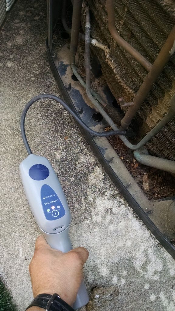

My AC compressor had its freon gas refilled back on 7/7/17 this past summer, and the effect of freon gas refill was immediate in that the AC air was icy cold. However, now in 9/23/17 less than 3 months later, AC air has become warm again so it's maintaining inner house temp around 85 degrees. AC is still working because it seems to be maintaining temp at about 84 or 85 degrees, but it won't bring the temp low enough. It also turns on by itself and turns off by itself which would be in response to temp change inside the house. The tech who did freon refill said my AC compressor is outdated, and if it acts up again, it should be replaced, and it will cost couple thousand dollars to replace the AC compressor unit.. The tech also said when refilling the freon gas into AC compressor, it's best to refill only up to 75% instead of full 100%. The AC compressor is TRANE brand and is about 13 years old. Is it possible it's low again on freon gas? Is there a way to check that myself? If AC compressor unit needs to be replaced, how much can I expect to pay in central Maryland region? Pics of my AC compressor unit is attached.

Most systems leak at the evaporator coil. You have a Trane outdoor unit so the leak is most likely outside. You have a picture posted of the entire unit. It looks dark under the large panel next to the electrical panel. This is the most common location for a Trane unit to leak refrigerant.
You can remove this panel and spray the bottom center area with soapy water to see the leak most of the time.

As mentioned, most leak is at the coil, not the compressor. never heard about 75% full, all nonsense. Since you have ice cold air before the freon leaks out, that indicates your compressor is in good shape. You need to call another tech to find out where the leak is and go from there.

You actually need 2 jobs performed. You need to find the leak before any repair can be made.
Locating a leak can be time consuming and if you are paying $140 for the first hour and $90 an hour for every additional hour this can get expensive.
I can usually find a leak within an hour with my Tek-Mate but I have not had much luck with other brands.
Depending on the location of the leak repair may not be possible and replacement may be (and usually is) required.
