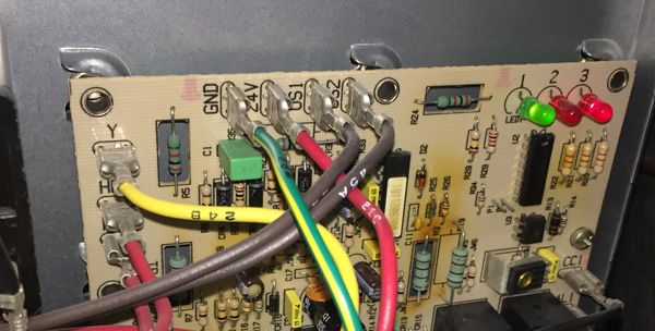

Sometimes it stays down, and sometimes not. When it doesn't, I noticed that I don't have the 26V to the contactor.
I was going to test the circuit board voltage and I accidentally touched the ground pin on the board and the compressor fired up. Every time it doesnt fire, I can just knock the ground wire with a wooden spoon and it fires up. Bad connection on the board?
Is that ground to the board or off the board?

PJmax's Avatar
Join Date: Oct 2012
Location: Northern NJ - USA
Posts: 50,582
Likes Received: 108
That's probably a ground to that board. Is there a part number on that board ?

I'm on the road so my access is limited right now. That ground wire looks like it supplies the common 24vac to that board. You should be able to follow it to its connection point. It may go to a screw on the frame.
I would turn the power off to the unit.... pull the board off without unwiring it and check the solder on those pins.

TB1-1: 24VAC.
TB1-2: ground (common)
Those two terminals are the power to that board are important.

The pictures you SEE are compressed but the large file size is stored here. Either save the picture or right click on it and select "view picture" for a full size view.
Those connections visually look fine. I'd imagine the problem is defective solder on the back of them. That's what you need to check.

right click view image redirects to photobucket. The src is on photobucket. Believe me I tried. I went into geriatric viewing mode and I can see it, but I still dont know where it is that I'm supposed to test.
It's come on about 12 times today every time.I put a new connector on with a bit of a snugger fit.

2 full days now without a hitch. It sure looks like it was the ground connection.
