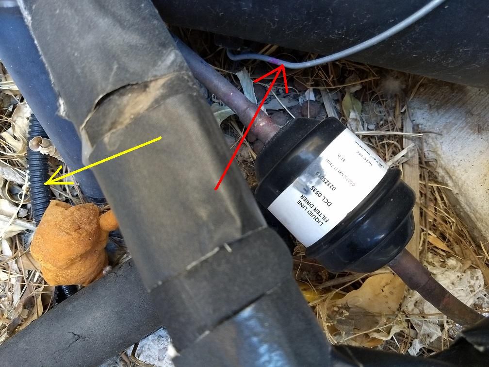

not sure what steps to take first, i just gathered a bunch of pictures for now

Is the low voltage wire even connected to this unit?

I believe it shown in AC4 JPEG.

I see an aftermarket high pressure cutout control that’s been bypassed, but the other pictures don’t show anything.
You’ll need some tools and a meter to troubleshoot. Do you have those things?
I don’t see a control wire going into the unit either.

The yellow arrow is pointing to the most likely location of your control wire.
It usually looks more like this but your wire is in a plastic conduit...
It will usually connect to the condenser with a couple of orange wire nuts...
Turn off the thermostat before trying to reconnect the 2 wires or you might pop a fuse in the indoor unit. Usually 3 amp for gas furnaces and 5 amp for air handlers.
