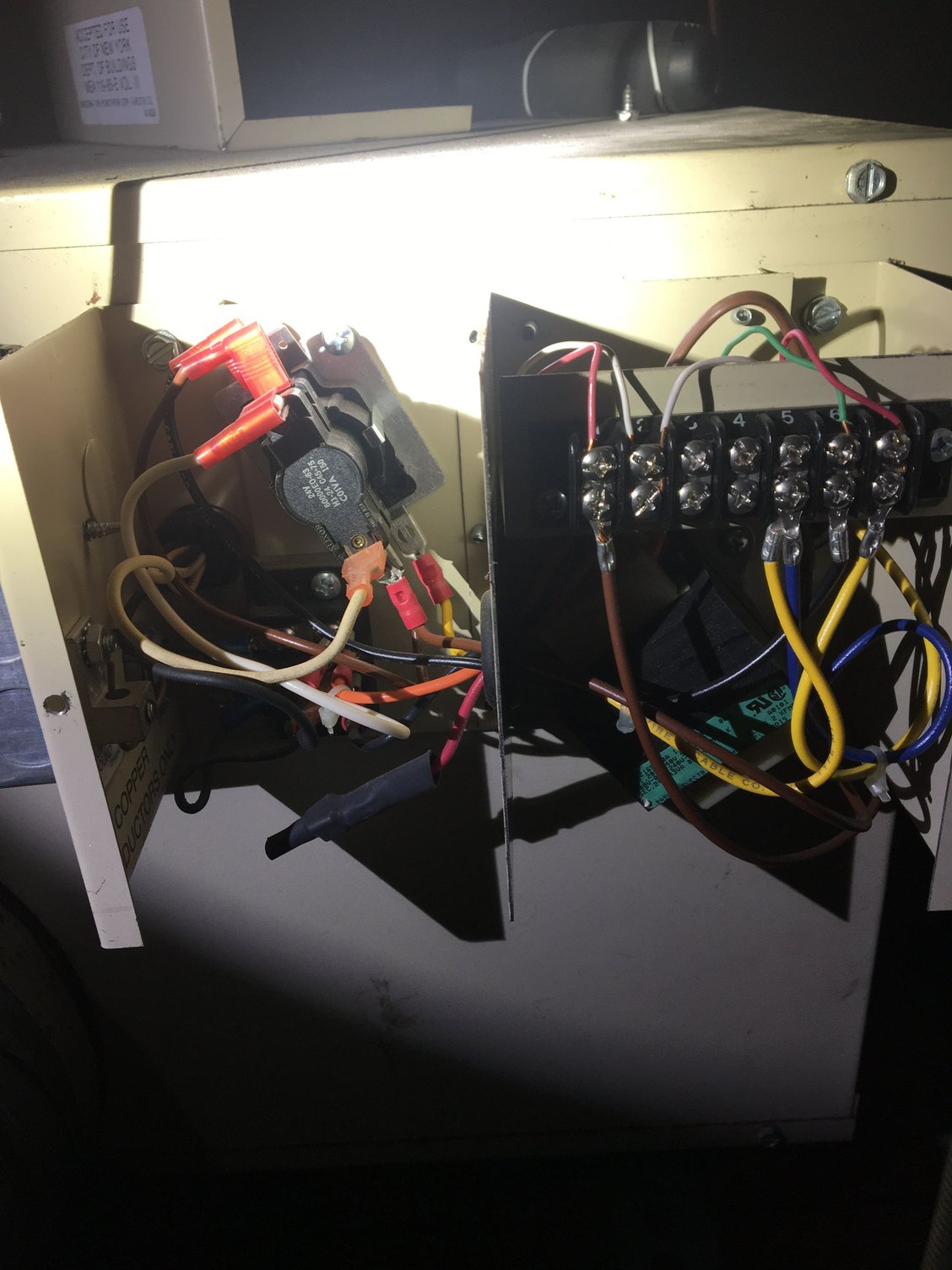

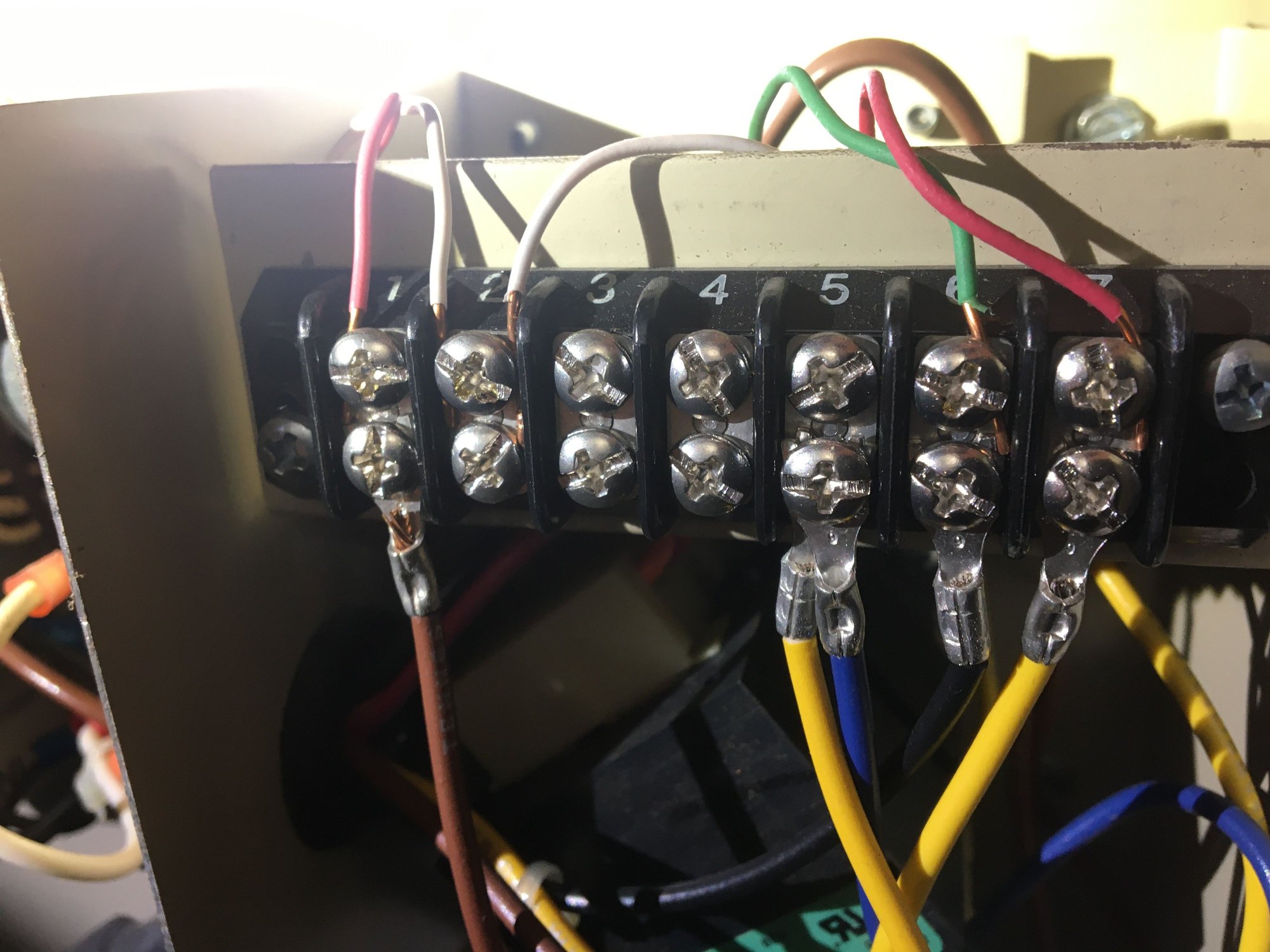

I'm trying to replace the existing old-school thermostat with a Nest, but there are only two wires between the air-handling unit (SpacePak ESP-3642D) and the thermostat (green and red, no common wire), and the Nest wouldn't power up.
First off, is it reasonable to believe the problem is the common wire, as my google searches indicate?
If so, I have some 18-gauge wire that I can easily get between the air-handling unit and the thermostat, but when I opened it up to see where to connect the common wire on the AC, I found no indication or labeling on the terminals other than numbers (see pictures).
Can anyone help me figure out where to connect the common wire on the air-handling unit?

Trying to come up with actual wiring.
That company has little to none helpful online information.
I'm still checking but ultimately you will need three wires from the stat to the unit.
1 - y ??
2 - x (blind)
3 - x (blind)
4 - x (blind)
5 - Common ? bridge
6 - green - blower
7 - red - 24vAC

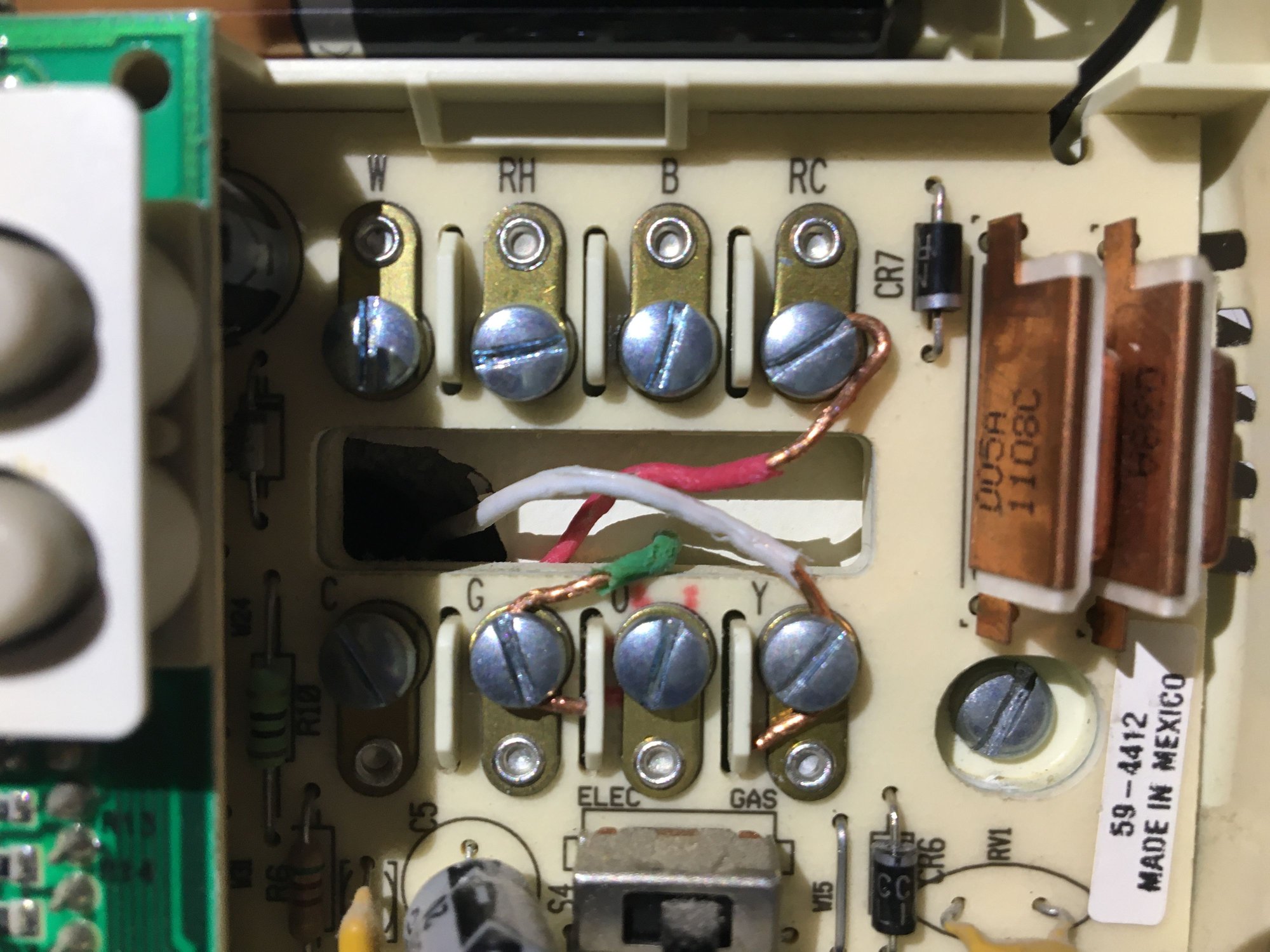

You're right - on closer inspection I do have 3 wires going to the thermostat. Don't know how I missed the white one at first (which I believe should be yellow, per your comment and the label on the thermostats). This photo shows how they're connected at the thermostat, and the white wire goes to terminal 2 of the air-handling unit.
The question is which terminal is the common wire. Is there any way to test that like measuring voltage or resistance across terminals?
5 appears to be the C. Verify by following its blue wire along with the yellow wire on 7 (R) - should go to the transformer with the green label underneath.

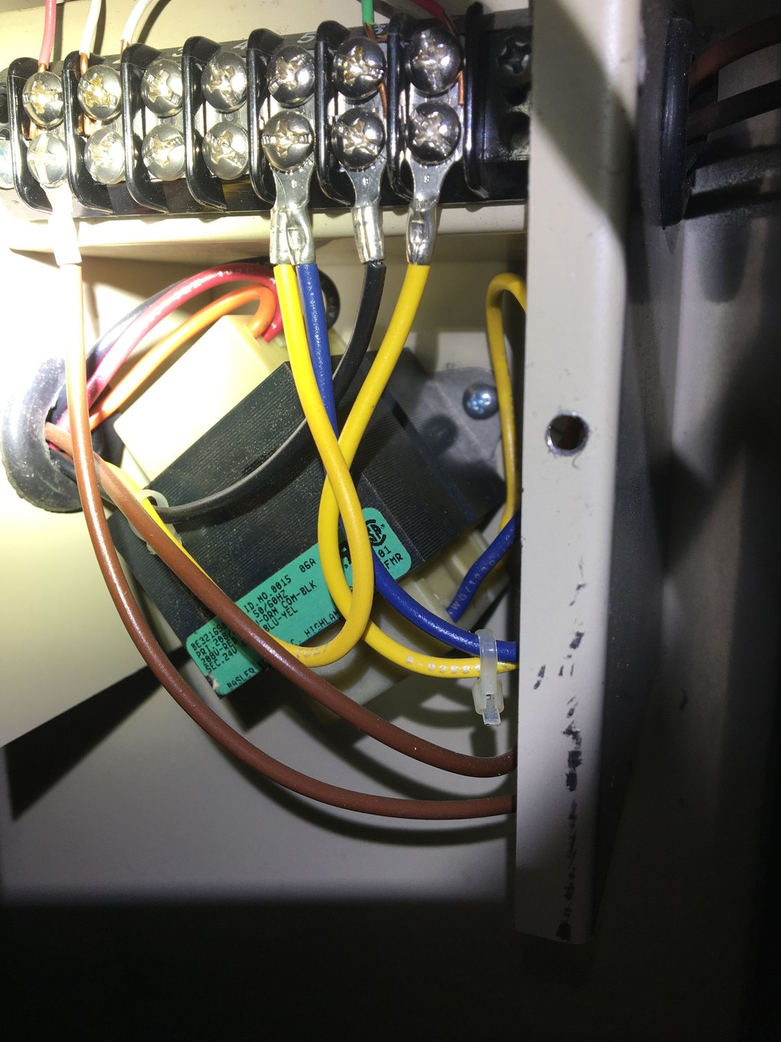

The blue wire does go into the transformer with the green label (photo below).
Thanks a lot!
So I should be able to run a single wire from terminal #5 to the thermostat's C terminal? If we're wrong about #5 being Common, what's the worst that can happen?
Thanks a lot!
