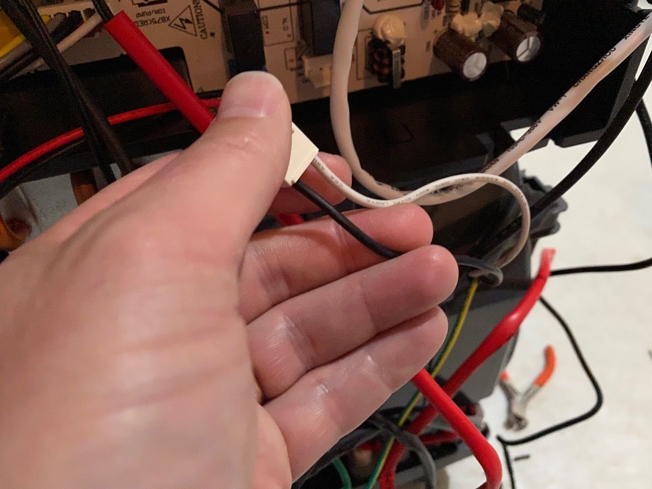

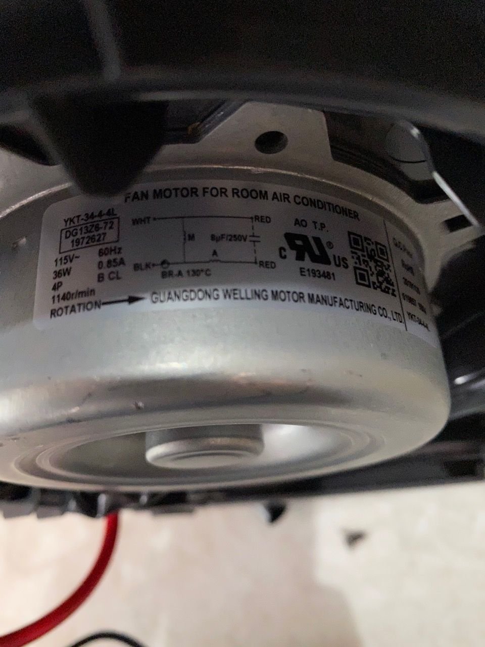

Connect the fan motor to the incoming power cable just like the compressor. That motor runs on 120v. The splash motor should no longer be needed but if it's 120v it can also be connected the same way as the fan motor.

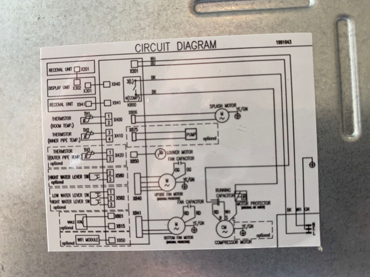

OK, so I tore everything apart yesterday electronically. Basically this unit has an upper fan to blow the cold air through the evaporator and out of the unit, a lower fan which pulls hot air off of the condenser and send it out the back to be vented out of a window. It also has a small splash motor which I believe takes water that collects in the tray and throws it up against the condenser to cool and evaporate it.
I was able to bypass the circuit board for the compressor. Basically I pulled the hot and neutral wires from the plug off the board, I sent the hot wire right to the compressor and I sent the neutral wire to the capacitor, which ultimately feeds into the compressor. I just cut and spliced the wires. That works fine, the compressor now kicks off when electric is supplied by plugging in the unit, just as I want, because I want to control electric through a temperature controller that probes the temp of the gylcol.
Here is where I can use some help. The lower fan motor wiring diagram is not clear to me.
I will attach some pics to this thread. Basically the lower motor has two red wires that go into a capacitor, Im assuming this is for overflow protection. That part is fine and does not need to be touched. In addition to the two red wires, there is a higher gauge white and black wire that come off the circuit board and go into the motor along with the two red that connect to the capacitor. And of course the motor is grounded as well.
So what I need to figure out is the white and black wires coming off of the circuit board. My assumption is that is just hot and neutral, but what's not clear to me is if they are being run through a resistor or anything else on the board, or if I can just splice my hot and neutral and send that right to the fan motor? The fan motor has a wiring diagram which I will attach a pic of. It looks to me like its running through an inductor, which doesnt make sense to me, because I thought only DC needed an inductor. But that is why I need help.
So ultimately, if I can kick off the lower fan motor automatically, I think I am in business. The splash motor would be great too, but I think that is optional.
So, can anyone confirm if I can just splice my hot and neutral wires from the plug, and send those to the lower fan motor, or do I need to do something else?
Pic 1 is lower fan motor wiring diagaram
Pic 2 is black and white wires coming from circuit board that run to lower fan motor
Pic 3 is overall circuit diagram
Thanks for any help!!

Hi, that wiring Dia. is hard to read, to fuzzy ,is sounds like you want all the fans and compressor to run at the same time, just curious how you intend to cool the glycol, are you planning on putting the AC evaporator in a tank of it?
Geo
Geo
Yeah, the diagrams are really small, that was best I could do.
The upper fan does not need to run at all, once I pull the evaporator out, the upper fan has no use. So basically I want to run the compressor, and the lower fan that pulls heat from the condenser. And if possible the splash motor too.

Thanks PJmax, much appreciated that is what I thought as well, but wanted to confirm with someone who understands this stuff better than I do. Ill give this a shot and if it works, I am in business, just have to carefully bend the copper wires to get the evaporator out without cracking the copper.

So I got all the wiring working, I have the condenser fan and the compressor kicking off as soon as electric is plugged in. Exactly as hoped, thanks for the help!
