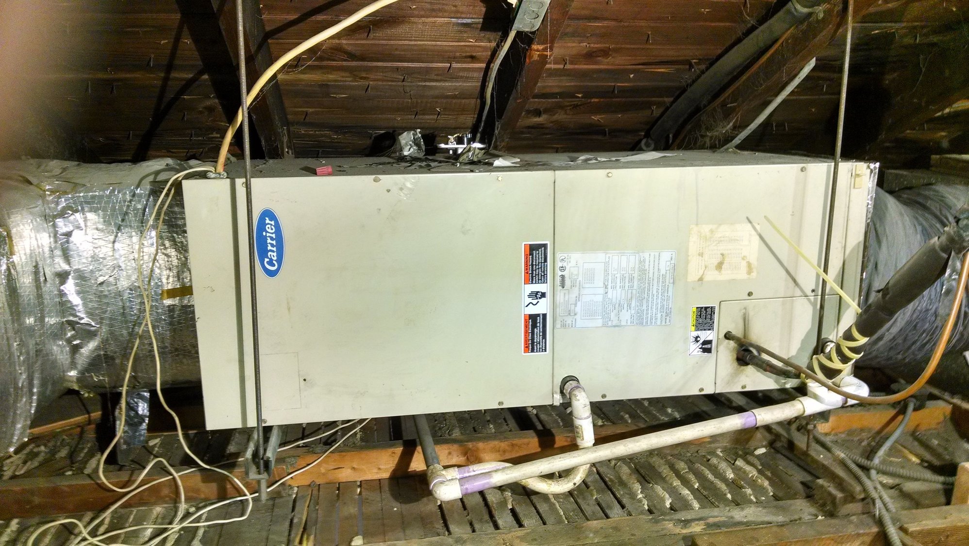

I looked up at the ceiling on my second floor the other day and noticed it was wet.
The condensate line clogged last year so I kind of know what to expect. I should also say, I'm coming around to the fact that I'm going to need to replace this entire system soon. It didn't hold pressure when I had a company out to inspect it several years ago, I don't know how it's held out this long. I'm deciding between just replacing the condenser (where I assume the leaks are, but it's r22) or the entire system (but I'm dreading the air handler/attic portion of the job).
I'm going to at least start to handle the problem tomorrow. I bought a drain clearing gun this time (it sucked last year trying to figure out how to snake the 3/4" pvc with sharp 90s) and tablets that should deal prevent/deal with the scum buildup over the next several months.
I'm start this thread off of memory because I want to have game plan going up there. Crawling around my attic to deal with this sucks, no room to stand up, crawling around in fiberglass, no room to stand, it's hot.
I attached a picture of the air handler that I took several years ago when I renovating the system (and installing attic insulation). Unfortunately, I can't find the model number, I'm going to get it tomorrow.
Anyway,
1. Inside of the air handler there is no real drip pan. It's lined in fiberglass that's saturated with water and then sort of drains out of the PVC (but the fiberglass stays saturated), is that normal?
2. Since the air handler draws air in (and all openings need to be taped so as not to suck in attic air/dust)...does that mean that air currently gets sucked in from the outside through the drain line?
3. I'm considering adding a full drip pan underneath the unit. Since it doesn't seem to be designed for it, would it be worth it?
4. Last year I installed a condensate overflow switch, so I didn't think I would have this issue again (at least not without the A/C shutting off), but clearly something isn't working properly (again, I'm going to investigate tomorrow).

If the air handler is R-22...... replace the entire system.
There are two drain lines on an air handler. One is always lower than the other. The lower drain is the primary drain. The upper drain is the overflow. Connecting them together like you have there is wrong. It's not always easy to see but one drain is lower. The idea is when the lower drain clogs..... water comes out the upper drain. In your case.... the float should be on the upper drain and it should not be connected.

Yeah, I couldn't imagine them being piped together was correct. Now I have to decide if I struggle to add a second drain tomorrow or not...I probably won't though with the goal being to replace the system in the fall and add it when I have more room to work.
But the fiberglass sitting in the condensation/water on bottom of the pan is normal?

No.... there should be nothing in the condensate pan but water.
You don't need to run a second line. Disconnect the secondary drain and use it for a float switch only.
Clean the primary drain. One way that many people clean the line is to suck it out from the outside.

And I understand, I guess I bought/installed the wrong type switch. Rather than threading into the drain port it clamped on to the side of the drip pan. Will know more about the issue tomorrow.
That type of switch is used if you have a second drip pan underneath your air handler.
You want something more like in the link. With this type of switch.... it could be removed and a few cups of bleach and hot water could be poured in to flush the pan.
Float switch
Float switch
So the air handler model is FB4ANA036. From what I can tell this is a 3-ton air handler? Using the sizing guide here, https://hvacdirect.com/sizing-air-co...nd-heater.html, I was thinking I would only need a 1.5 ton system (for an approximately 1000 sq ft area). Have things changed in 40 years (something I found googling said 1982) or was this just installed way oversized? A little more information about the system, there (6) supply ducts and only (1) 2'x2' return on the second floor (at the top of the stairs) - There is lots of positive pressure in the bedrooms lol.
Anyway the leak seems to be from the bottom of the plastic drain pan, it must be cracked :/ glad I've come around to a new system...temporarily I just bent some aluminum flashing I had as a drip tray and have it (more) safely dripping into a 5 gallon bucket in the closet through the access hatch.
