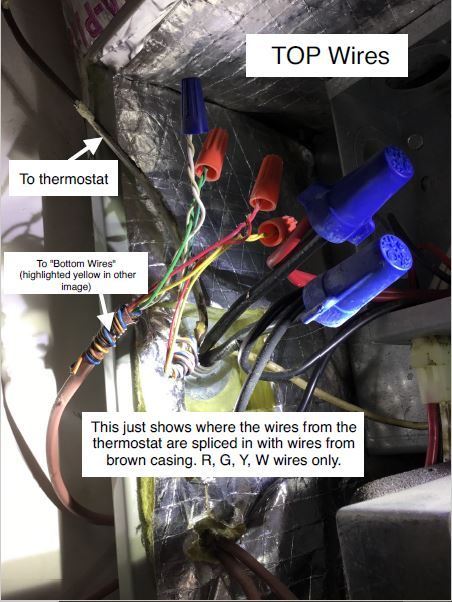

Hello! I am trying to install a smart thermostat but I am having some trouble identifying the C-wire in my unit. I have four wires at the thermostat and I need to attach the included c-wire adapter to go from four wires to five wires - (I'm sure it's common knowledge, but from R-G-Y-W to R-G-Y-W-C.)

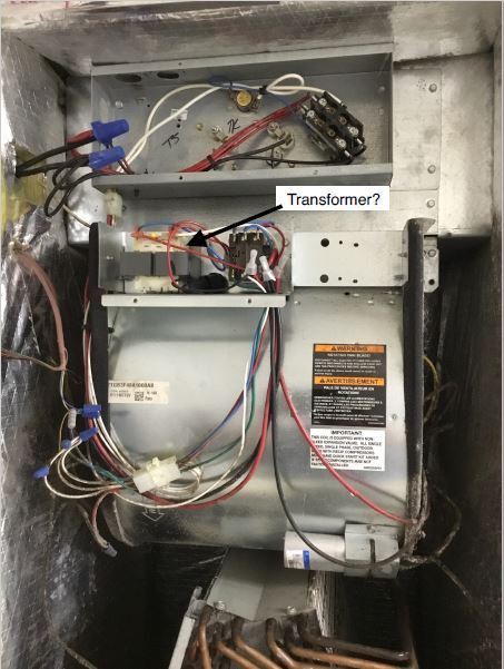

I have a 12 year old Trane unit with no control board (at least not one that I have found). I have traced the wires the best that I could with my limited (non-existent) HVAC knowledge. I TRIED to read the wiring diagram...
I have attached pictures that I hope will help. Please let me know if more pictures are needed, or if you would like to see the diagram.

This last picture is just a full view of the wiring so you can trace the wires from their connection to the thermostat wires.

Welcome to the forums.

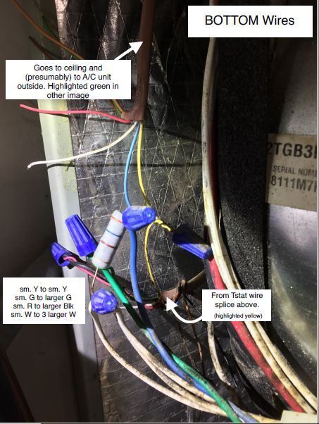

The cable that goes out to the condenser has a blue and yellow in use.
The yellow is the Y signal from the thermostat.
The blue wire is the C wire.

Not exactly sure what converter you are using. I don't use them.
It looks like you have the wiring correct.

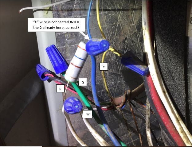

I thought as much! I just needed the confirmation! Thank you so much!
So, I will connect the smaller wires that I have labeled in the picture below to the 4 pins at one end of the adapter and then I will connect the corresponding labeled wires from the opposite end in their place, correct? (G with G, Y with the Y going to condenser, R with Blk, W with the 3 larger white)
Then the wire labeled C on the 5 wire end of the adapter will be attached with the smaller AND larger blue wires already held together with the wire nut (all 3 together)? I'm guessing the resistor stays connected right where it is?

That resistor was probably added to help a power stealing thermostat charge better.
You should be able to remove that now.

1.
2.
