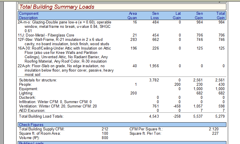

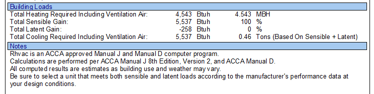

Just to give you some perspective, the load calc below shows (very loosely) your 100 sq. ft room in Phoenix. One door, one window (South side), guessed at construction. Increased outside design temp from 107F to 125 F. Crappy loose construction. Still not at 1/2 ton needed. Obviously this is just an exercise and the actual variables are different. Gotta think 2 tons of cooling in that small room would be quite uncomfortable.
Carling700, NYC-ORANGE-44 voted this post useful.
