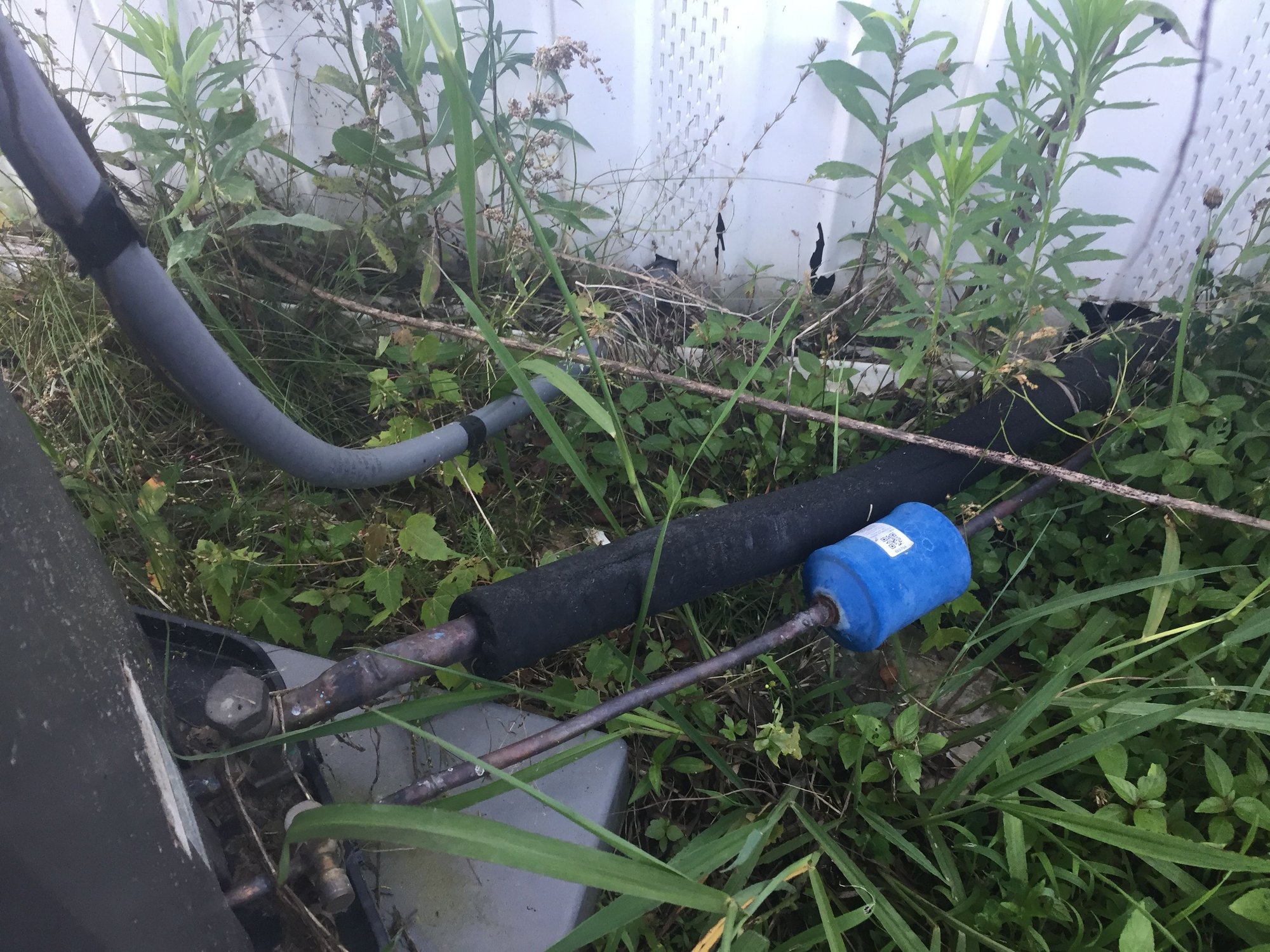

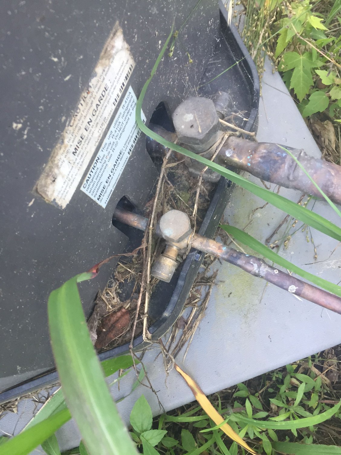

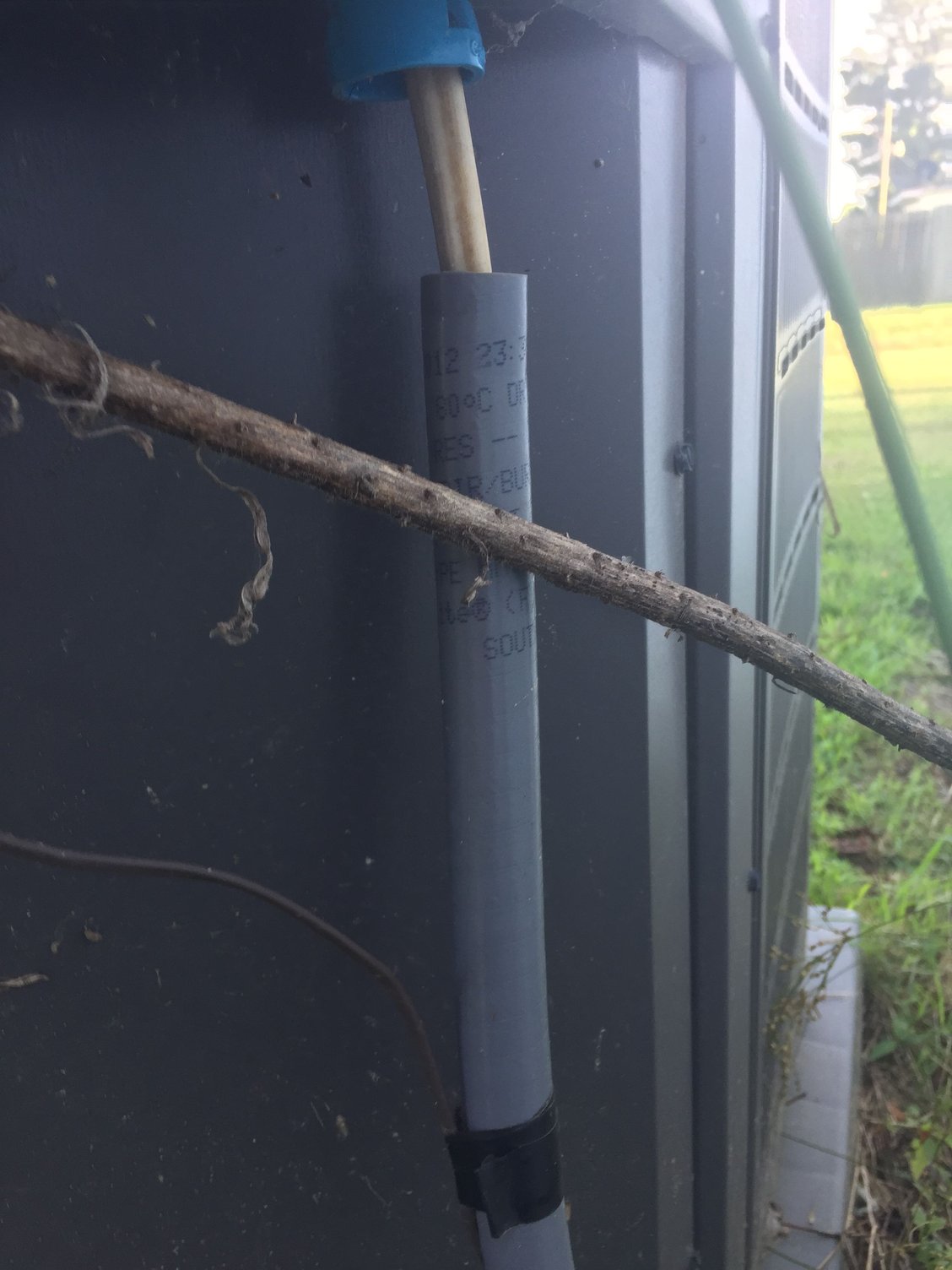

Bob, sorry for the terrible photos but these are all the cords I see coming from the back of the unit to the underpinning. These all seem intact and new I don’t see any holes or dings but I could be wrong. Idk what it looks like under the home but I don’t think any animals can get under the underpinning.
The small cable that is taped to the larger sheath in the middle picture is the cable I'm referring to. If there are no breaks in the cable from the condenser to where it goes into the house, then that is not the problem. I suggested this because this is something that you can check yourself without requiring any equipment (voltmeter). If you have a voltmeter (multimeter), we can give you further instructions on things to check.

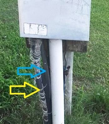

That’s what I’m looking for to try next but having a hard time finding it. It’s not close to the unit like most. Would this bottom grey box be the outdoor power supply or is that still part of the electric meter thing? Sorry if that’s a dumb question. This is literally the only thing I can find for outdoor power supply and if it is how do I get the front panel off to get inside? I can’t get it to come off
there is a high pressure switch located on the smaller line coming off the compressor. if it trips again call your land lord to have the coil cleaned they don't need to come into the house to check the pressure and clean the coil.
I can't imagine why the breakers would be "outside" of the home, but I'm not an electrician. There probably is a panel inside the house. Go ahead and open the panel door you've shown and take a pic for us.
The box below the meter is not the disconnect for the condenser. The electrical disconnect (if you have one), should be located near the condenser unit. Actually, in looking at the first picture you posted, it appears that the 240VAC power cable that powers the unit goes directly into a hole in the skirting. What Tinkerman was asking was if you tried resetting the circuit breaker (on your breaker panel) that controls the 240VAC power to the outside unit. It should be marked, but if it isn't, you could try turning all of the circuit breakers off and then back on one at a time. Let us know what you find.

There is only one house. It’s a mobile home. The power pole that has the two grey boxes is on the side of the house. If you look back where the house cuts the corner around that corner is right where the outside AC unit is. I’m going to try to flip all the inside breakers off and back on tomorrow wait 30 min and see if the outside unit is working If not I’ll see if I can figure out how to open that grey box I’m pretty sure all that is just for the electricity company but I’m not sure
#27
The top half is the meter and is sealed.
The bottom half is called a disconnect panel.
The bottom door will lift up from the bottom.
You will have at least one breaker.... probably a 2P50A breaker for the home. (yellow)
You will have a second breaker in there. My guess is it will be a 2P30A for the A/C condenser. (blue)

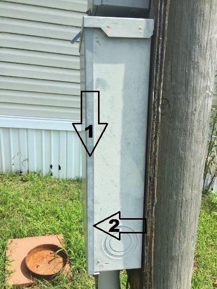

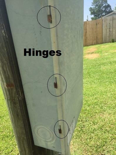

...and I can’t get the grey box open. Anyone have any other ideas?
Call your neighbor and see if they can open it for you.
#31
Join Date: Jul 2020
Posts: 20
Received 0 Upvotes

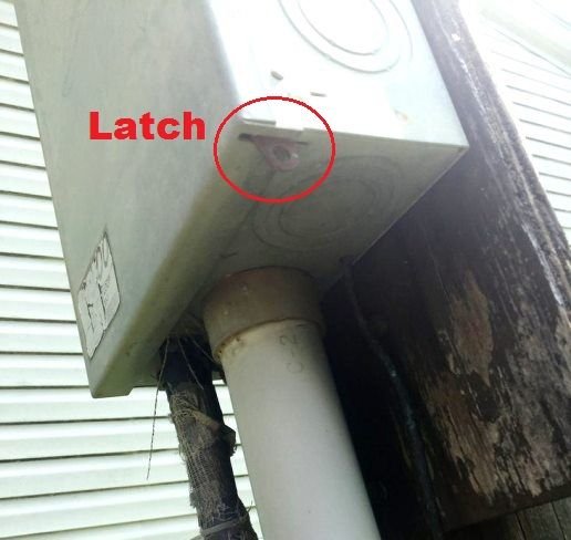

I just took pics of the sides so if anyone knows how to get it open I’d appreciate it. I tried lifting up from the bottom and that didn’t work
#32
On the bottom right hand corner is the latch.
I think you pull the catch forward and pull on the door.
Move the latch around until the door drops down about 1/2".
The door will drop down and hinge open from the right as there are hinges on the left side.
#35
Doesn’t look like it would open by lifting it up because the cover is under the lip, does that locking device on the bottom move?

Omg it fixed it everyone!!!!!! The outside is working and the vents are blowing cold air!!!! Thank you so much for all your help. This cancer patient can finally cool off thank you thank you so much
#39
So good you're back in the cool.
Since the breaker out there tripped...... if it trips again..... the problem is outside and should be able to be addressed outside.
