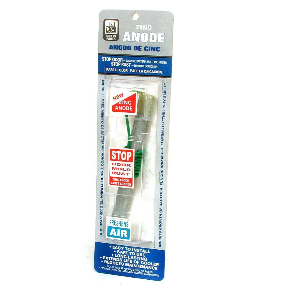

Zinc anode, $13 from big-box store.
If you check around the local small -boat or scrap metal shops, you could probably pickup zinc-boat-anodes at pounds-per dollar prices, BUT you'd have to cut them into mountable pieces.

That beautiful sea breeze, where you can literally smell and taste the sea, ALSO means that sea salt will eat your A/C units in 24 months.
You are effectively "on the water" in the same way that a boat tied up in your back yard is "on the water."
This means that the ultra-thin steel or aluminum that makes A/C units efficient (cheap) will quickly corrode and develop pin-holes that kill the A/C units.
This means you have to maintain your A/C units like a steel boat in saltwater: you want to connect a block of zinc to the A/C unit metal, so that the block of zinc corrodes and protects the expensive steel or aluminum pipes and cooling fins.
Anodes don't work like that. You can't just bolt one to the fender of your car and expect it to prevent corrosion. That's why you only see them used underwater. They need to be immersed in the electrolyte (water) and electrically connected to the metal needing protection.
1) Based on the time I've spent in Florida (Ft. Lauderdale) there is LOTS of humid air. And A/C units in humid conditions dump huge amounts of water.
2) The A/C units are grounded. Within a few feet of a salt-water bay.
3) Based on the number of kids with lead poising in Miami-Dade, it looks like there are plenty of lead drain pipes in the Miami metro area. Which means the lead pipes in contact with saltwater are completing a galvanic circuit.
When you add 1) + 2) + 3), you can conclude that humid salt air and saltwater in contact with the ground wire beneath the house is likely electrically connected to lead drain pipes which would create a galvanic circuit that quickly corrodes steel and aluminum that are grounded to saltwater-saturated soil.
Water vapor in the air is not an electrolyte. If putting anodes on something in the air worked you wold see them on almost everything metal. Have you seen them on cars, trucks, bridges, sign posts... If you want further proof take a look a boats on the hard, dealers lot or in on a trailer in someone's driveway. The anodes do nothing to protect against corrosion while the boat is out of the water.
