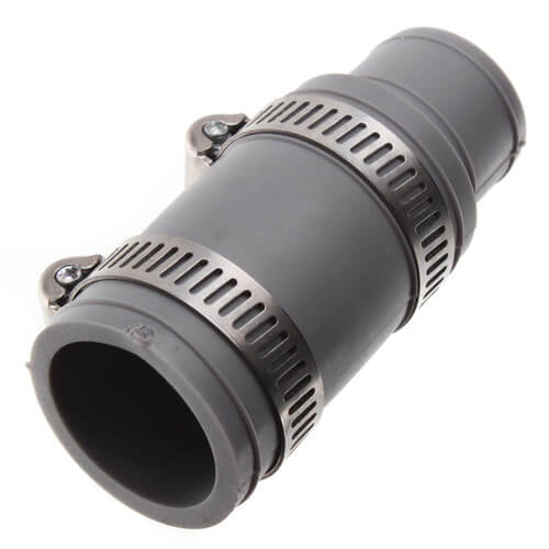

Usually leaking is caused by a clogged drain. I would cut in the straight horizontal section where the wire is draped over. That would allow you to snake back towards the AC as well as downstream. I make one saw cut then you can usually pull the pipe aside enough to clean it out. Then I get a rubber dishwasher drain hose boot and cut off the narrow end. Slip the larger diameter section over the pipes and secure with a hose clamp on either end. Then in the future the rubber boot can be removed to clean the pipe again.
