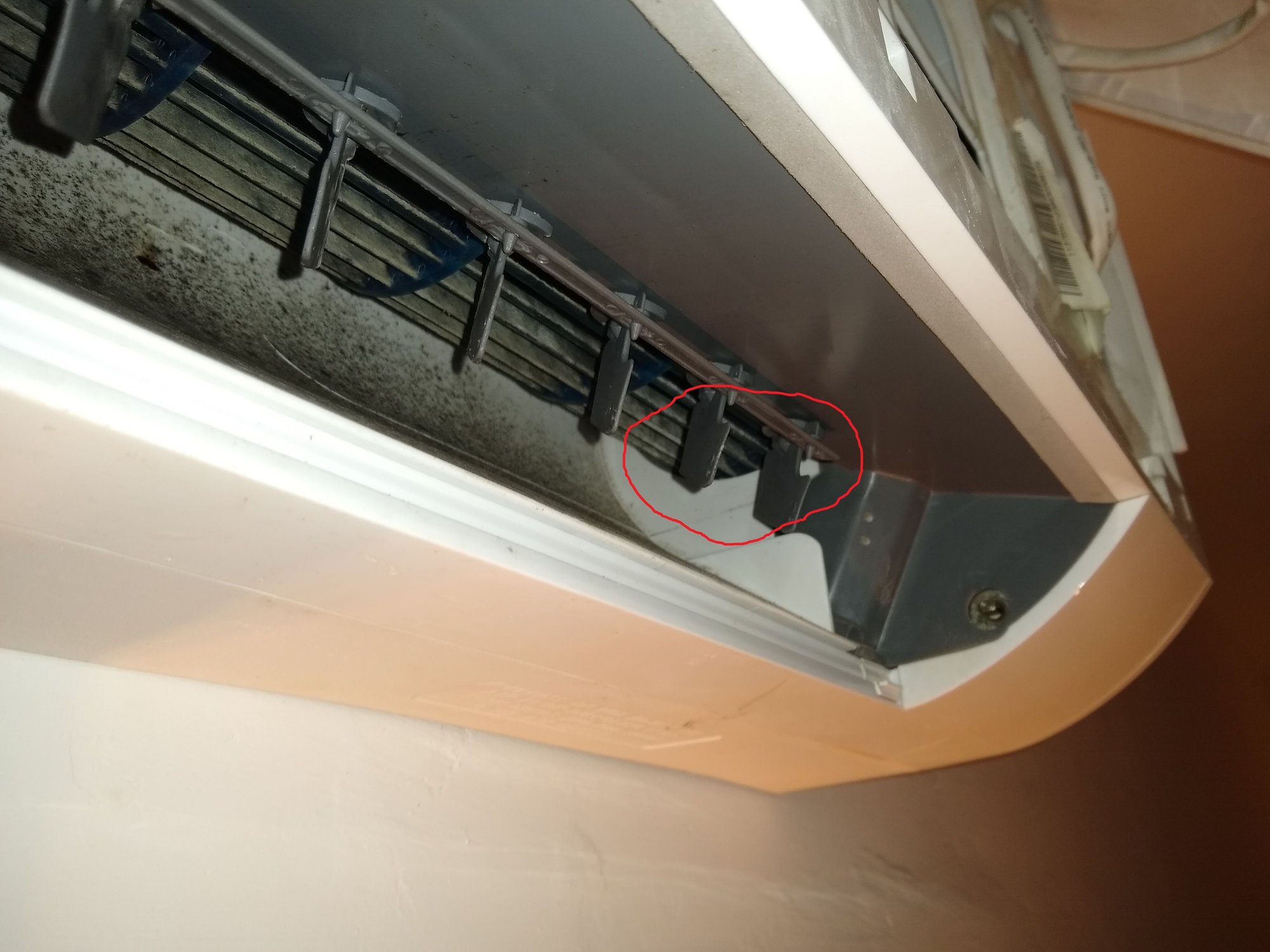

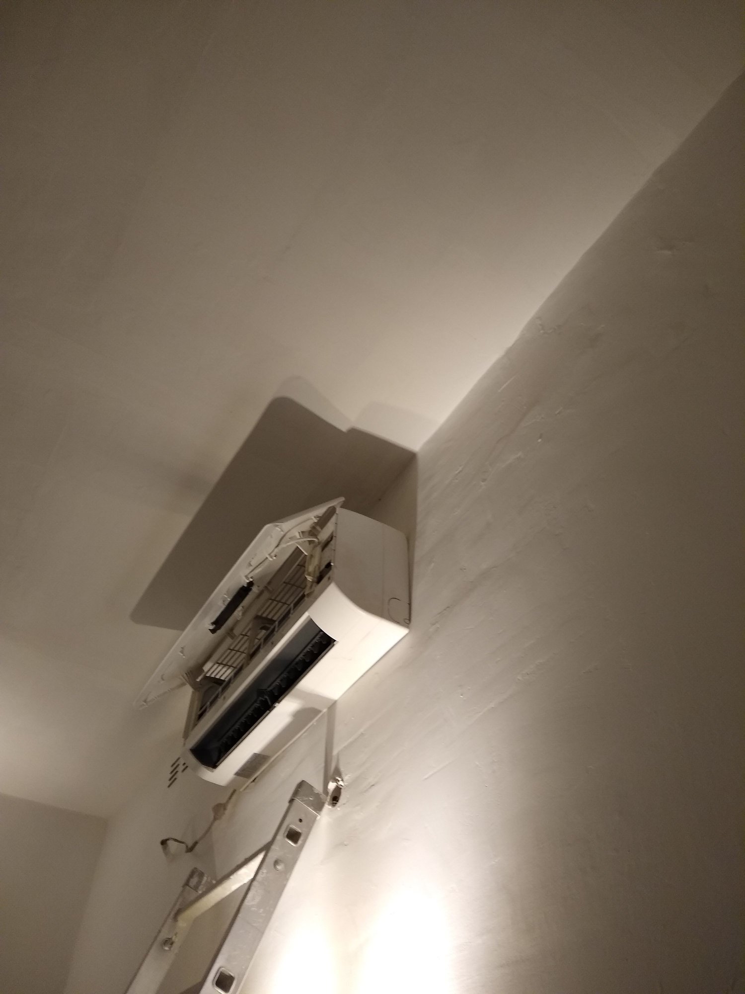

As the title says, my AC unit started making noises and vibrations!
The unit I'm talking about
The brand and specs

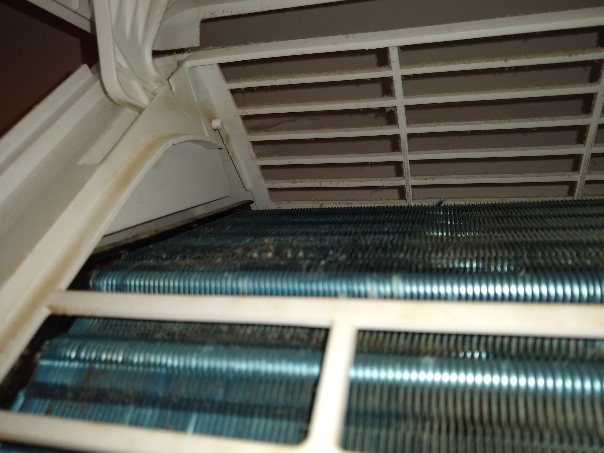

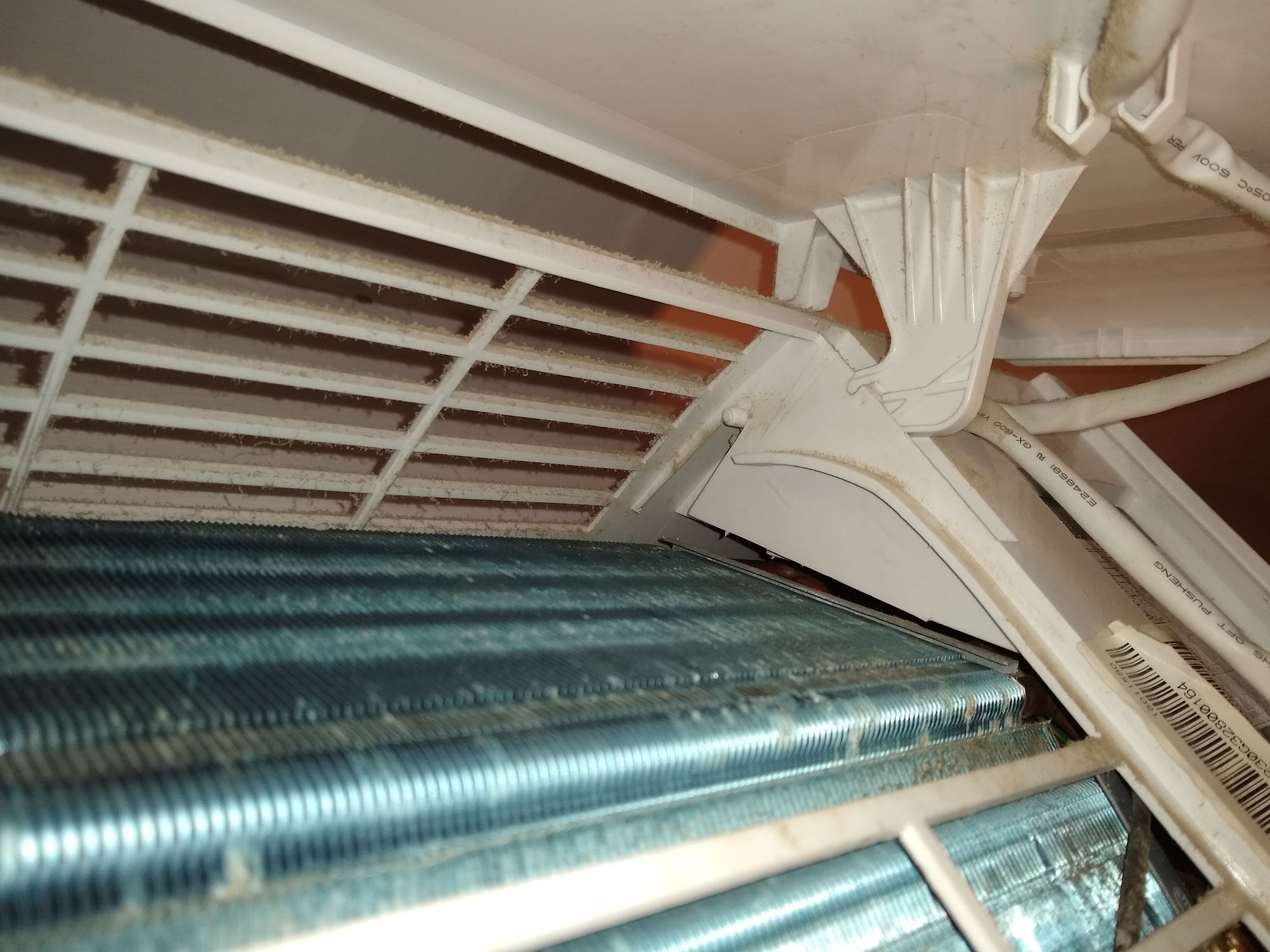

I've investigated a bit and I think it's the fan that has drifted out of place and is scraping against the bottom; Which makes sense given what the noise sounds like, and how it changes with the fan speed, etc.
Those are the blades of the fan, and the area where it seems to scrap. Sorry for the mold!
Left side, attached firmly
Right side, attached a bit loosely
Okay good start! But now I'm unsure on how to proceed further...
I don't see any visible screws I could tighten or anything. Or an easy way to remove more of that plastic cover either.
The problem seems so dumb and straightforward! Surely there must be a way to fix it myself?
Thanks!

Look inside the fan's cage (the part with lots of "fins" that turns) where it attaches to the shaft. Often there is a set screw or two that locks the cage in place. If they work loose the cage can work out of position and rub.
Your third photo with the red circle shows where you should look for the set screws that attach the cage/fan. It will probably require at least some disassembly to be able to access the area.

I don't see a way to disassemble further, unfortunately... I guess the access points are at the back and it would need to come off the wall first
It won't come off the wall..... the refrigerant lines are holding it in place.
Usually the cases are removable.
