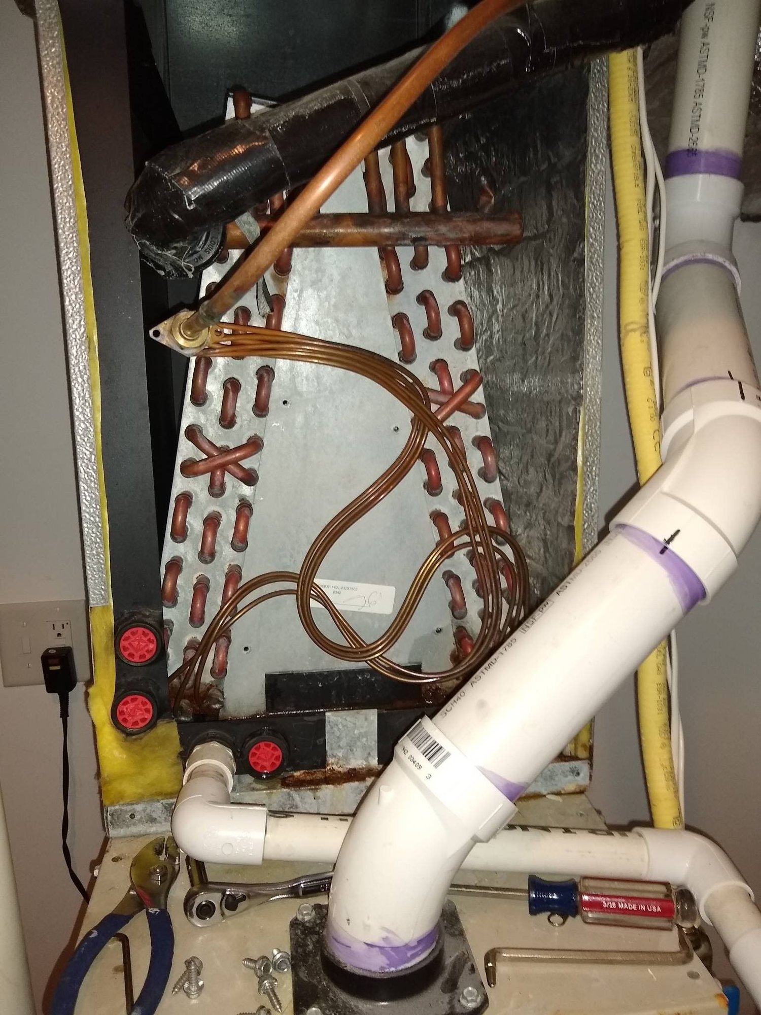

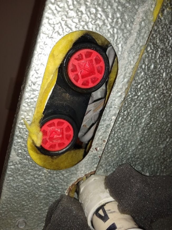

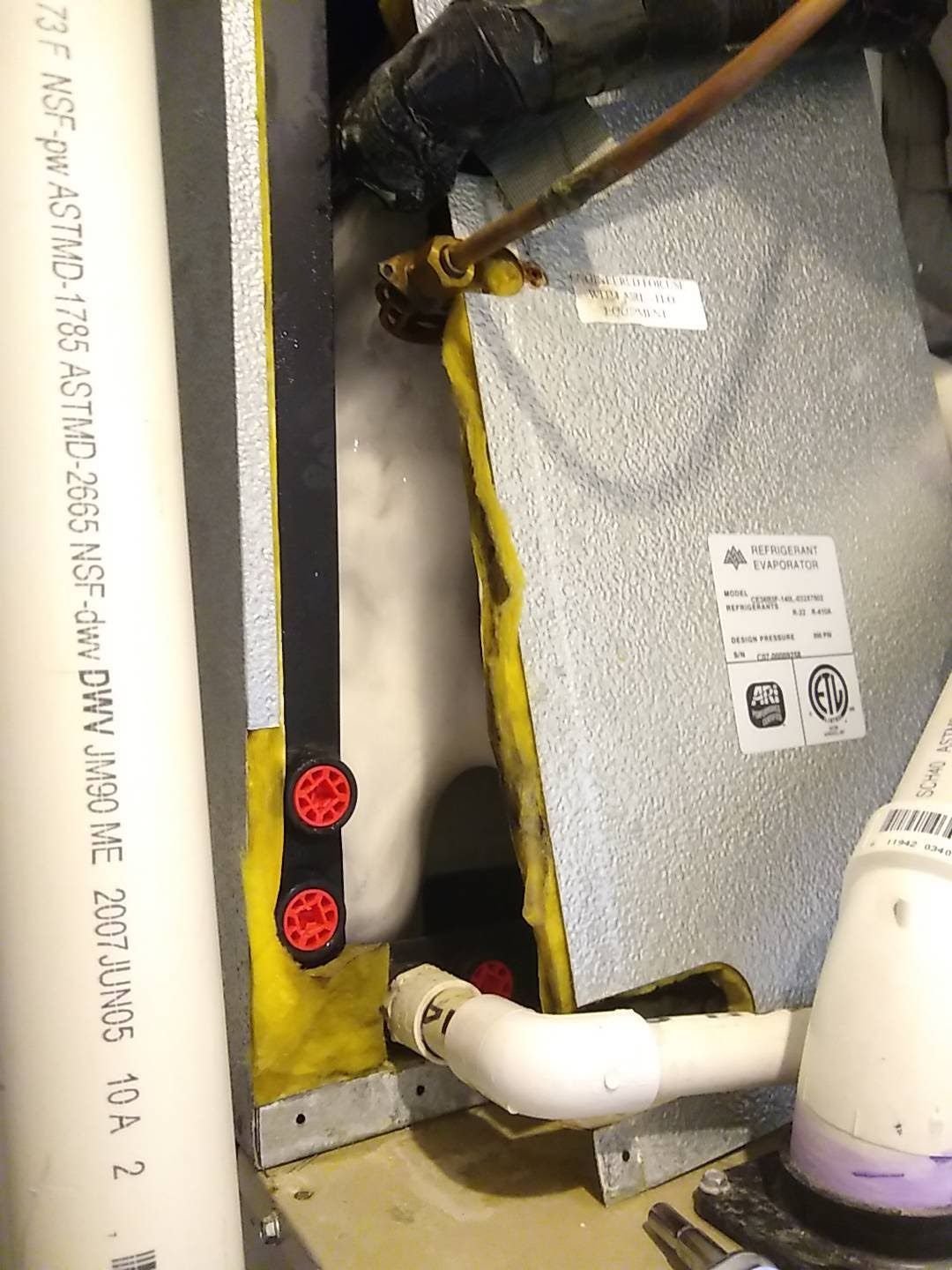

It has taken me two days of painstaking step by step work, but I now have access to the Evaporator Coils (top side only). I can't figure out how to take off this Triangular Access Panel.
Some pictures are attached. Is the triangular metal attached to anything internally? It doesn't seem to want to come out. Could it be rusted in place? Or does the metal fold inside and attach elsewhere?
Step One: Notice the ice inside
Step two: I finally got the door out of the way, revealing evaporator coils (top side only)
I can't get the triangle out - it seems to be either rusted in at the bottom or otherwise attached internally.
Note - can that white drain pipe be unscrewed? i wonder if maybe it's blocked (although i poured some water in and it drains fine)
I shine my flashlight inside, and it doesn't seem particularly dirty (like i've seen in YouTube videos), leading me to wonder whether this is even the correct diagnosis after all?
Thanks in advance .

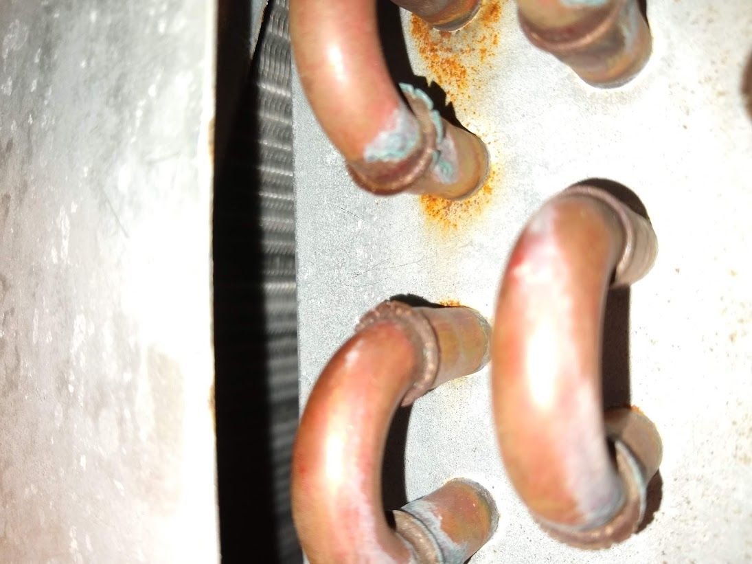

I poured the bleach and hot water in today, and then closed everything up. The temp has fallen by a few degrees in the house, but i must not have done a great job sealing up the evaporator coil housing (duct housing? not sure what it's called) -- its got cold air blasting out from a bunch of different nooks and crannies.... along seams etc
I'm not sure if those are new or they've always been there and i just never noticed.
The inside humidity has dropped from 60% to 55% pretty quickly (I had the unit completely off for a few days) ...
I'm going to use some HVAC tape over these holes.
I did peak a flashlight in one of the holes before taping it up and it seems the coils have a LIGHT coating of frost --- is that minimal amount of ice normal?
I'm going to turn the temp way down and see if the temp keeps dropping.
See the picture. That frost on the lines is after just 30 minutes or so....
If it's still a problem, i suppose i'll have to surrender and call in the Pros

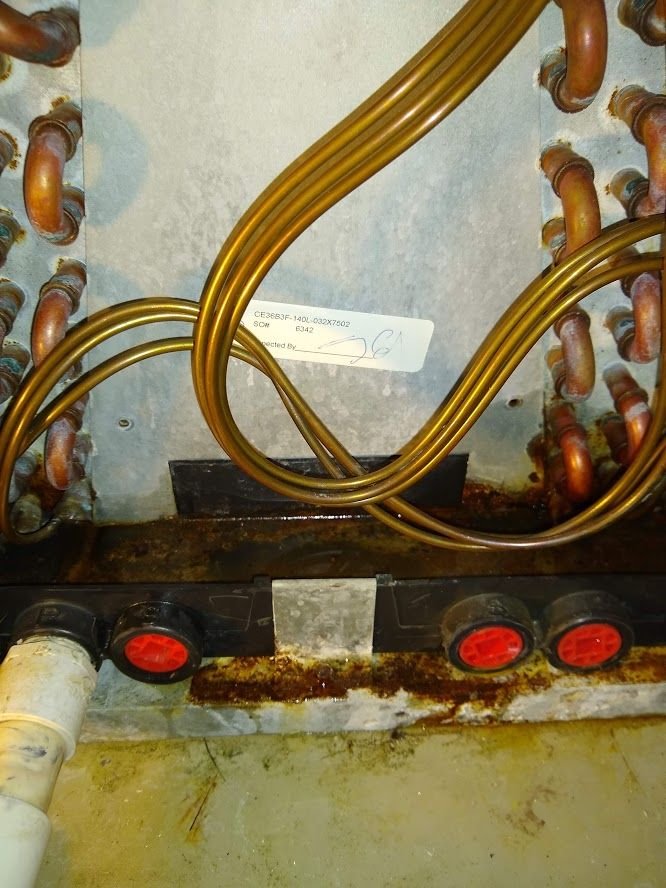

I opened it back up - coils covered in ice.
Just to recap what i've done
1- cleared drain line with bleach & hot water
2 - visually inspected bottom sides of evaporator coils - couldn't really get in there with any spray due to access issues but they seemed clean
3 - changed air filter
4 - outside, cleaned out any debris out of the compressor unit and did the best i could cleaning the coils (there's no hose)
Regardless, after a day of use you can see the photos below. This leaves me feeling it must be the refrigerant, and I'll have to call a service tech Monday.
I should note - i did feel cold air blowing out in the vents around the house but i felt it was running for longer than it should to get the desired temperature reduction....

There is two things that can cause that..... low on charge and low airflow.
Did you have a good airflow from the registers ?
If yes..... looks like your next step is to have the charge checked.
