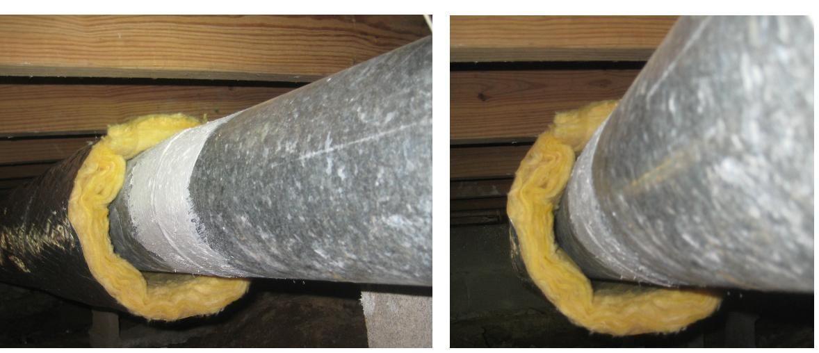

Am I cutting/installing this duct wrap correctly?
The instructions say to measure P+13 inches, where P is the circumference of the pipe, and cut a 2" tape flap on the side and end.
6" circumference is 18.8 inches + 13 = 31.8 inches. I rounded down to 31 inches here:
It's really loose, but if I am reading this correctly, it's how they are saying to install it. There's like a 2 inch gap in some spots... I exaggerated the looseness here by pulling up in the first pic, but if I center the pipe it's not as bad.
I know there is supposed to be some air gap, but I'm I doing this correctly? I'm assuming I am, but wanted to check to make sure, or see if there were better methods.
Here's a pic of it installed on the duct in the crawl space:
Also are there any quick formulas or methods for cutting 6" elbows?

Id adjust some to remove the gap, you dont want to compress insulation but the gap isnt doing anything!

Thanks Marq1... yeah I contacted the manufacturer, and they said it should be snug but not tight... so I will cut it smaller and remove the air gaps.
Not sure why they instruct it to be cut so loose, though...

I always say "A good job looks bad" with respect to duct wrap workmanship. And don't forget the required staples and UL181 tape (bearing UL181... marking).
