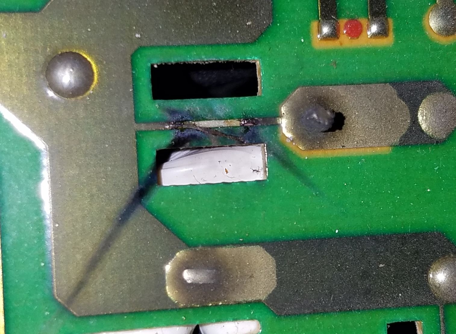

Here's where I'm at since I started back in it this morning after a fitful and short slumber in a ~90° house:
Using PJmax's search suggestions, I found line power is good (PDF from thedealertoolbox.com), and low voltage control is good enough (terminal 1 to 15 is 16.8vac instead of 24vac, but 1 to 12 tests at 24vac. This is ok per the reply to Marc2theMax's youtube comment).
Motor: Specs out fine at ~5.2 on each coil (<20ohm spec), and OL for each to chassis ground. Motor spins fine by hand.
Thermistor: Per various sources, it seems the thermistors are a known fail point on these. Mine appears fine, and tested fine at 1.2ohms (I think it was ~1ohm spec). No other obvious failures on top side of board.
I removed the board just to see if there were any obvious failures on the backside, as I'm pretty well out of common failures to look for at this point, and sure enough, there is a blown fuseable trace. I'm working to get someone with better tools and skill than I to solder a jumper on this afternoon. If it doesn't work, I'm considering a used unit for ~$200 shipped (motor and board) that can be here in 4 or so days.
Per "t" in his review of the Zebra thermistor repair kit on Amazon, he had a burned trace too. Says his research indicates it's a shorted microchip under the potted material. If so, oh well, I was going to have to buy a replacement anyway. If this works, then hooray for money saved!
Couple other places mentioned burned traces for various motors in mostly furnace applications. No photos matched my board exactly. Only one guy said he jumpered his and it worked fine. I will make sure I follow up if this turns out to be disastrous or not.

Kaboom as soon as I threw the breaker. Anyone want a grenaded controller?
Circuits blown away everywhere!
The jumper post kaboom

Yes.... that's a fusible link. You needed to check for what was shorted and caused that to open.
Quite a blast.
