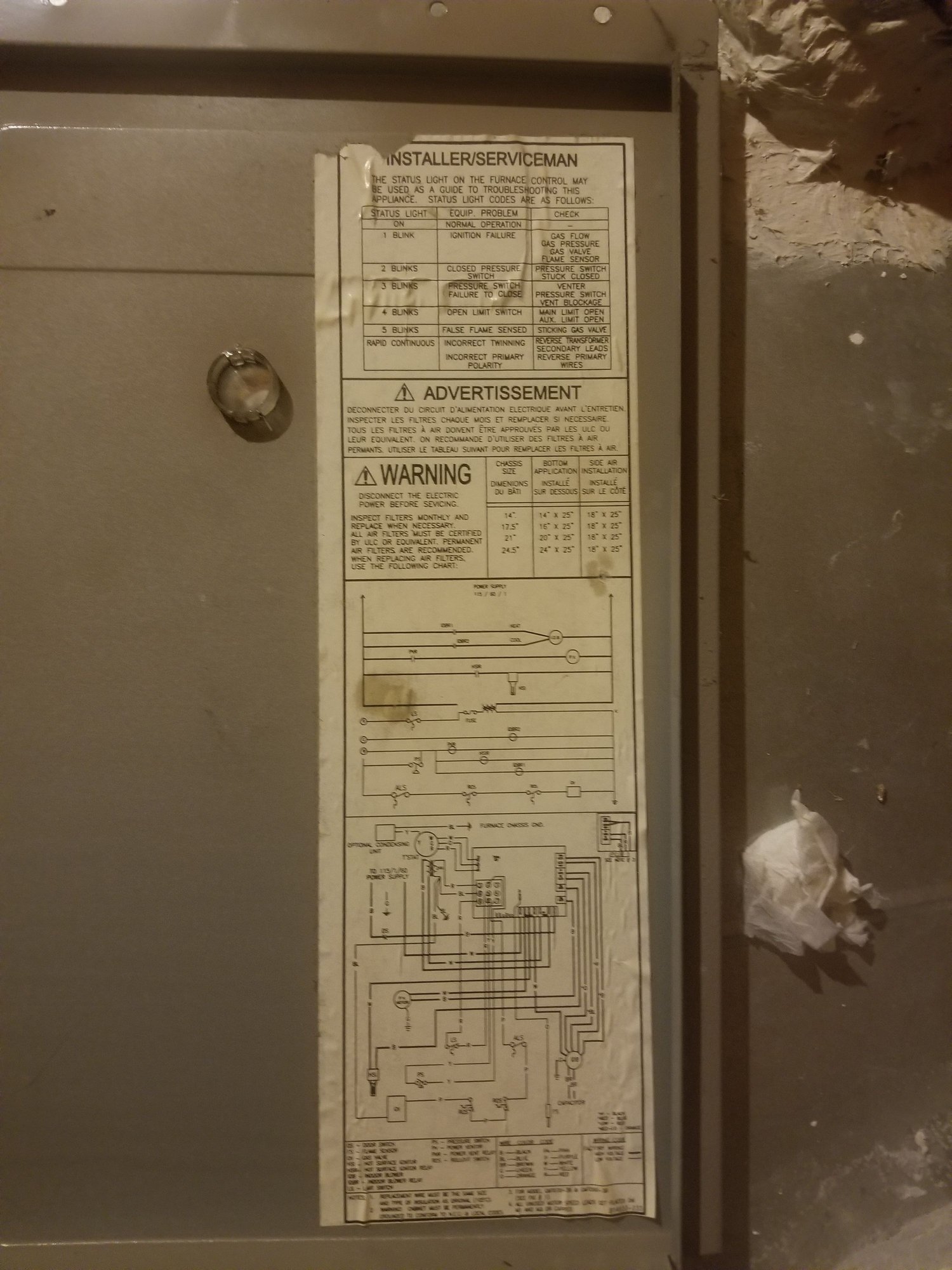

I could not find the sticker, but I found the wiring diagram without the model name on it (see attachments)

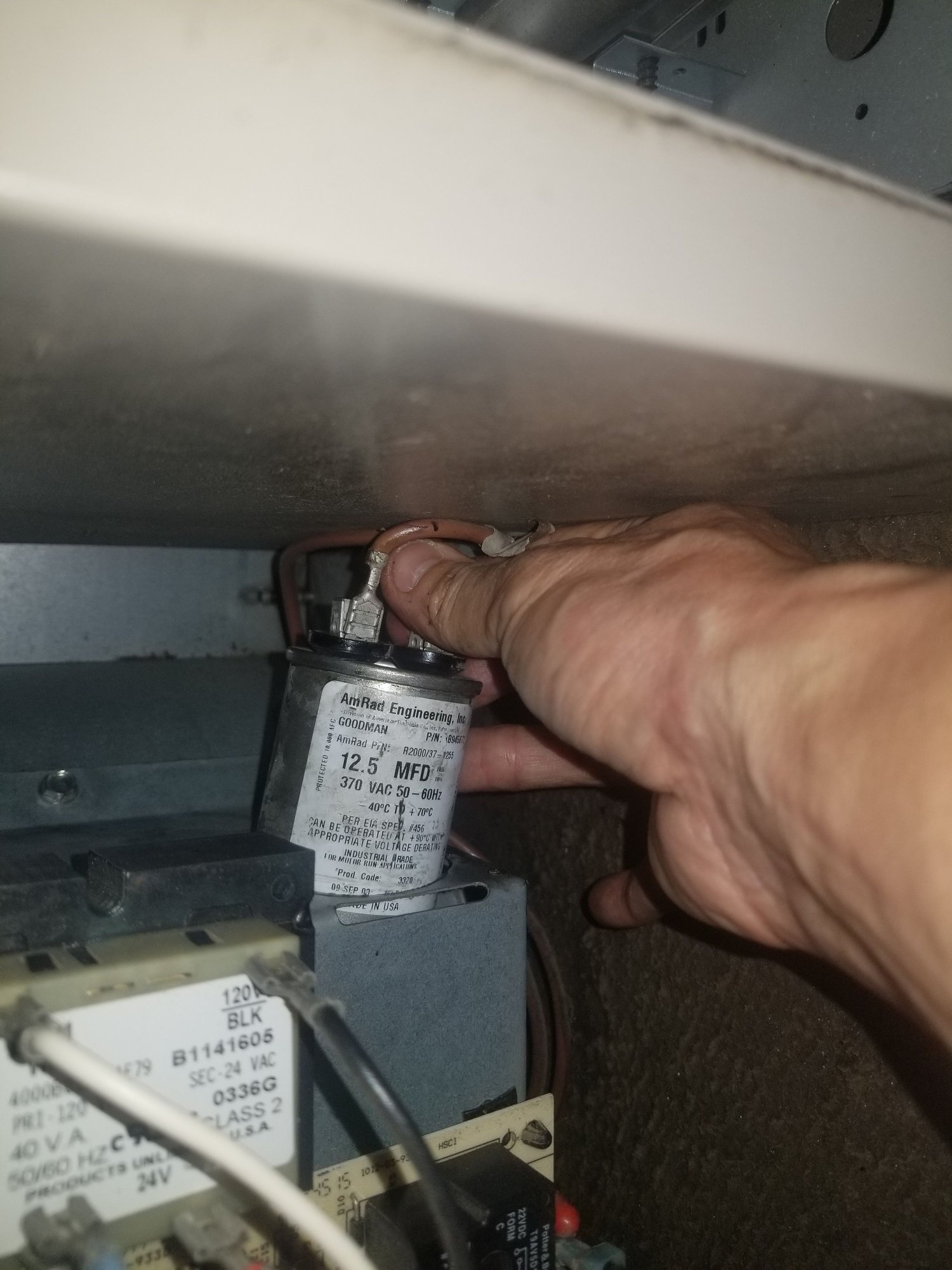

Also I checked the Capacitor attached to Control Board , I do not see any visual damage(see below):

Unfortunately, the picture of the wiring diagram is too low resolution to read. Can you take another picture of the wiring diagram that includes only the wiring diagram portion of the label and is at a higher resolution?

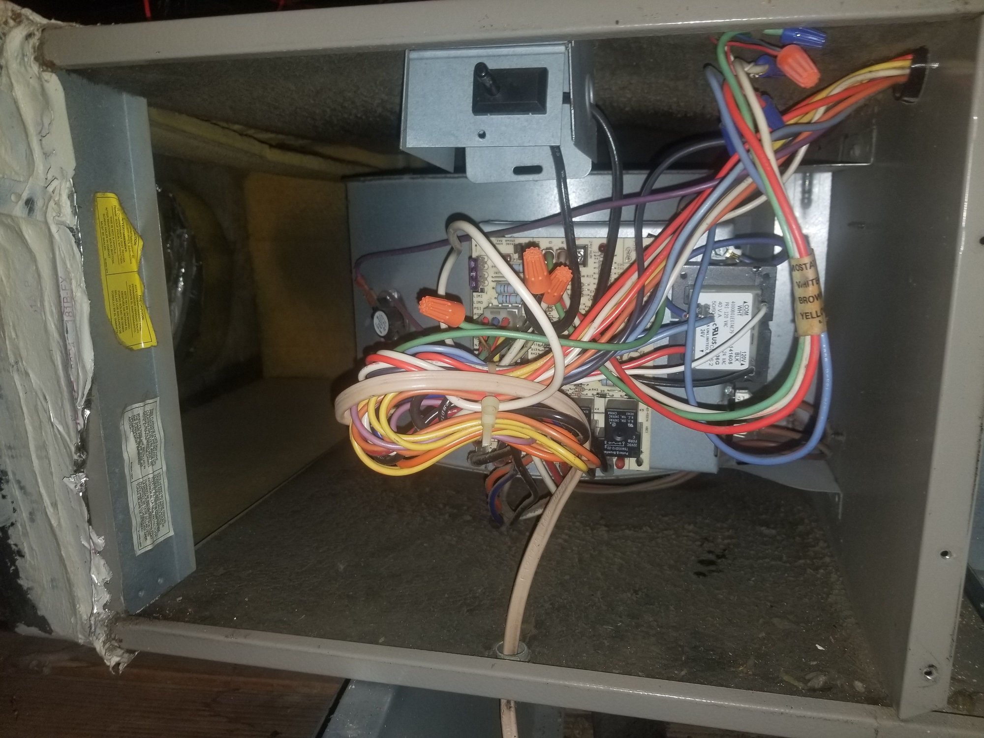

The model number can be found on the side wall near the burner.... behind the burner access cover.
I can see by the wire nuts in the blower wiring that the blower motor has been previously replaced.

I back home yesterday. After I done the online research for several days when I was out of town, then found the cause of the problem was the bad capacitor for startup the fan, so I replaced the bad capacitor yesterday , now the A/C fan back to normal. I hope I posted this resolution that can help a lot of people in the near future.
