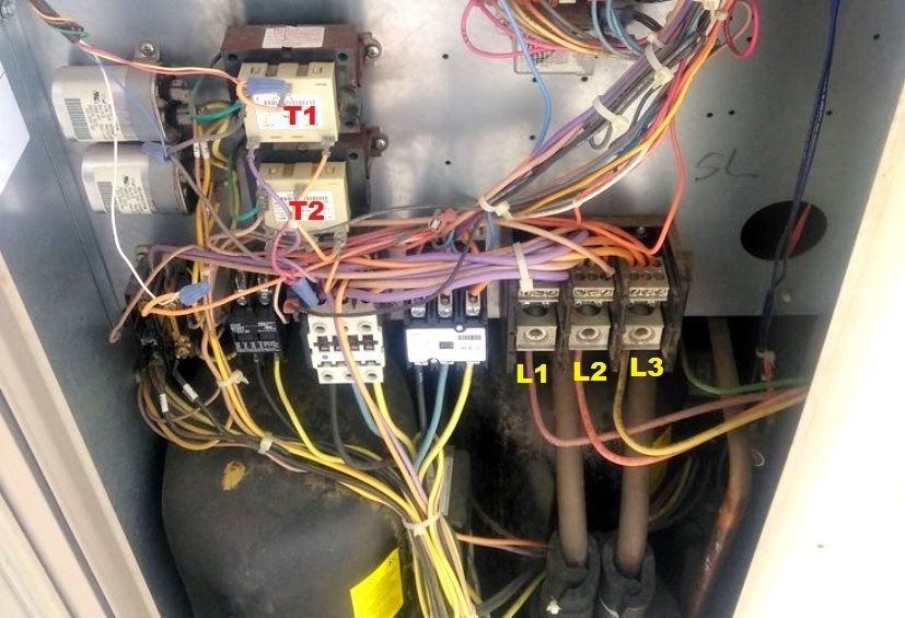

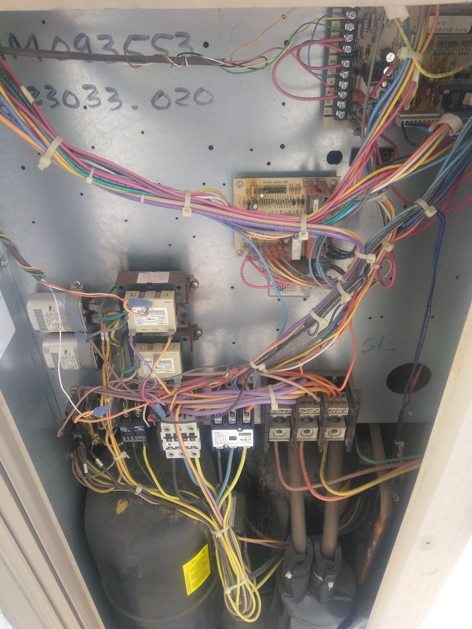

No power to the unit i do light maintenance on 23 units filters fuses cleaning. But if i can i try to not call a company if i can fix it. Fuses are good, will a bad run capacitor keep power from the board so no led is blinking?

Start from the source. Is there high voltage to the unit?
Thats not a unit to use as a self teaching tool. It’s 3 phase and looks like it’s likely 480 VAC by the wire gauge.

Is this 480vAC equipment ?
If yes..... you need to be using an arc suppression face shield.
You should also be using nothing but a name brand meter...... preferably a Fluke or equivalent.
480 is dangerous stuff and I've seen "run of the mill meters" blow up. It's not pretty.
You need to confirm you have all three phases. L1 - L2 - L3.
I labeled the two transformers for discussion. You need to check for what should be 24vAC output.

you have no business working on that unit but as others have said that is a 3 phase unit and probably 460V.
do you have line voltage on L1 L2 & L3 or do you not have control V. there should be a control fuse on the control board check for control V look at your wiring diagram check both of your transformers for power in and out
