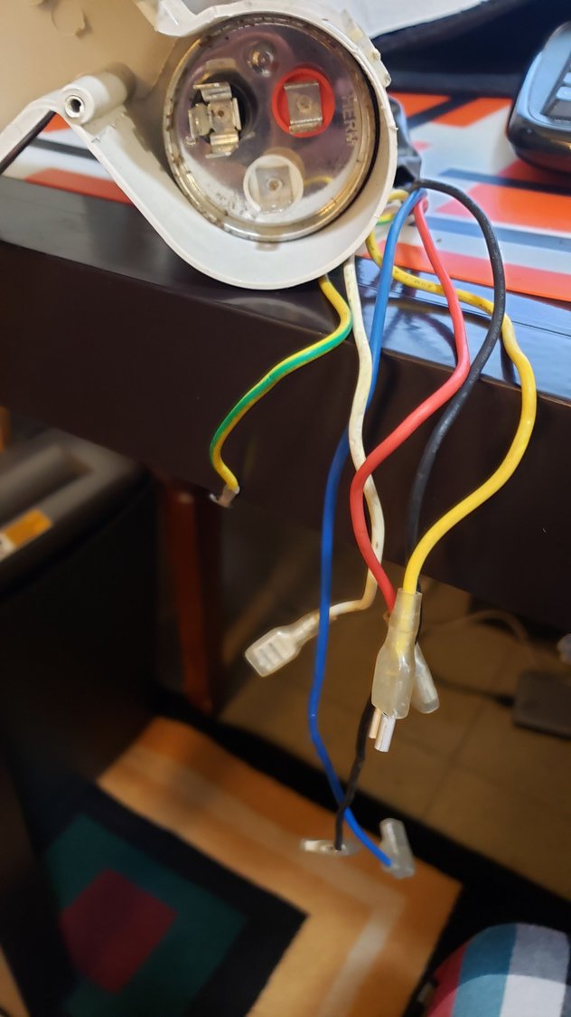

Motor not working.
i pulled a motor to replace. I cannot understand how to attach with capacitor.
can u pls guide. Thank you
Motor and capacitor wires

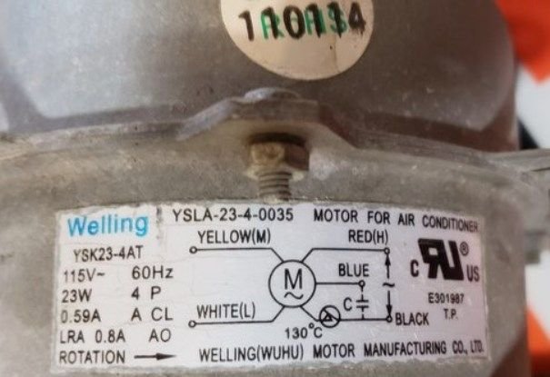

Are you sure that is the capacitor that belongs to that motor ?
It certainly doesn't look like it.
You motor is a three speed motor.
Your capacitor is a two stage capacitor for an A/C compressor and condenser fan.
Condenser fans are typically one speed.
If you are certain they are meant to be together........
Connect motor black to black terminal on capacitor. Neutral wire also connects to this location.
Connect motor blue to white terminal on capacitor.
The hot wire to the motor connects to one of the three wires below depending on the speed wanted.
White = low speed
Yellow = medium speed
Red = high speed.
