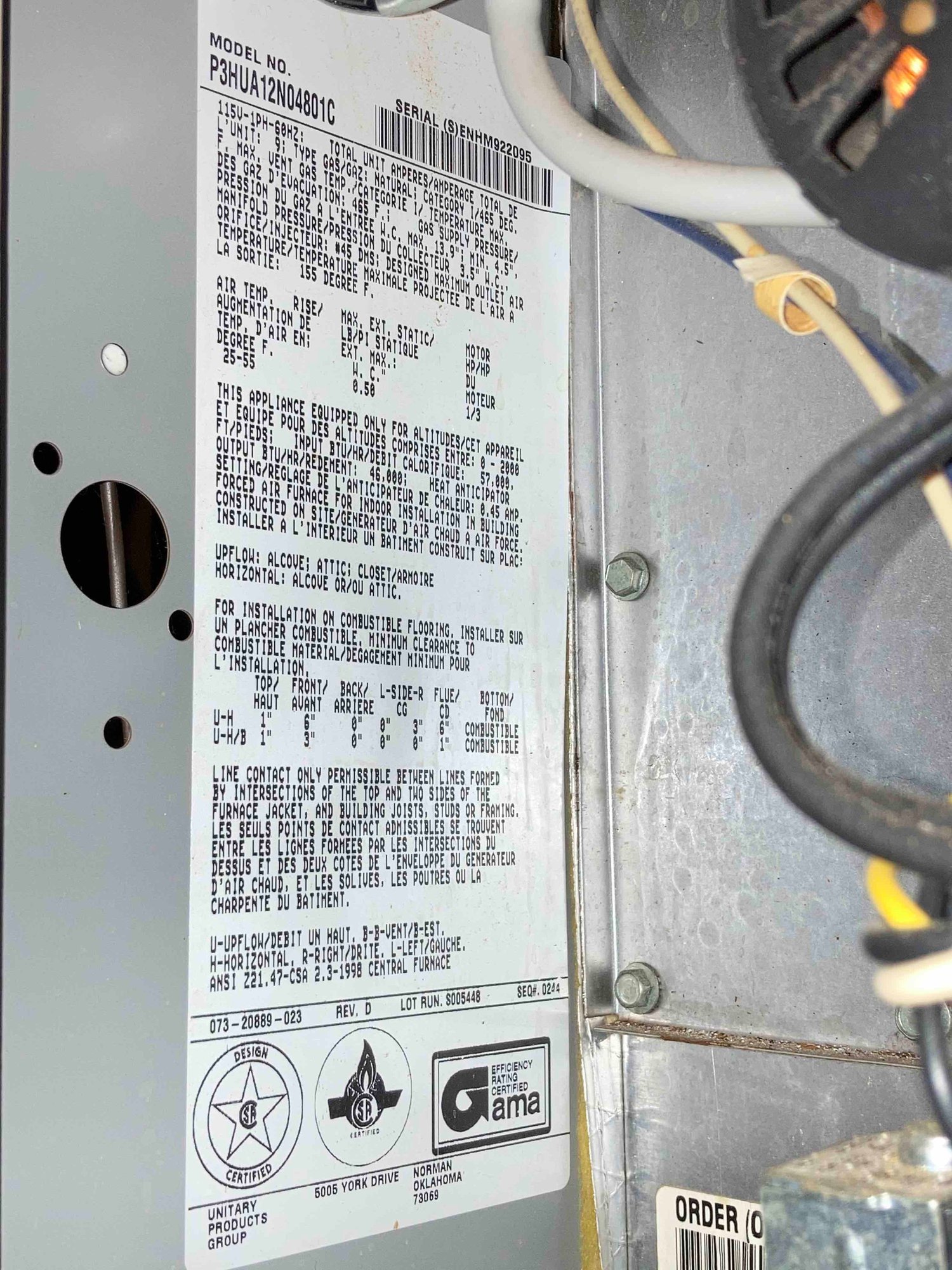

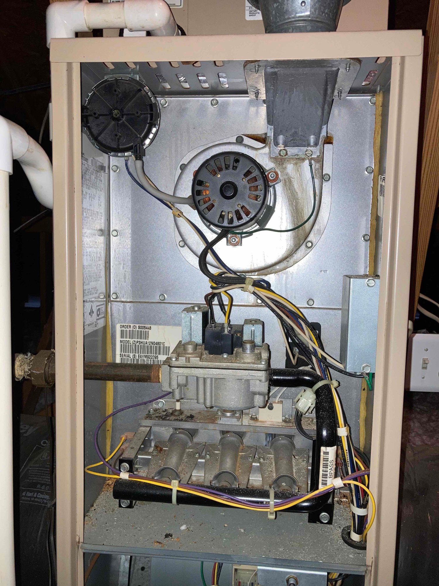

Join Date: Nov 2017
Posts: 27
Received 0 Votes
Hi PJMax,
I found the system is called YORK Diamond 80, Model No: P3HUA12N04801C
I attached 3 pictures of the unit.
Where can I find the delay timer or blower control relay?
Thanks!
Thanks!

Yes..... that's a York gas furnace. It uses a White Rodgers 50A50-241 control board.
Since you've removed the stat and still have the problem.... it's a furnace problem.
It's one of two problems.....
1) the heat of the attic triggered a heat sensing safety switch to open.
2) the control board is defective.
The control board has a timer that turns the blower on and off in heating mode.
I labeled your 3rd picture. The control board has a fault LED on it. (red arrow)
The chart tells you what fault you have based on the flash count. A safety switch opening will trigger a fault code. If you are getting the normal LED flash.... then the board may be defective.
You need to get the flash code before removing power. The switch in blue circle kills all power to the furnace when blower door is opened. You must read the code before opening the door and erasing it. There may be a sight glass where you can look thru at the code.

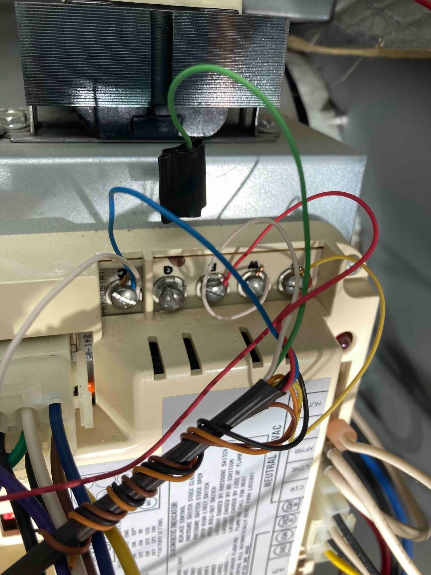

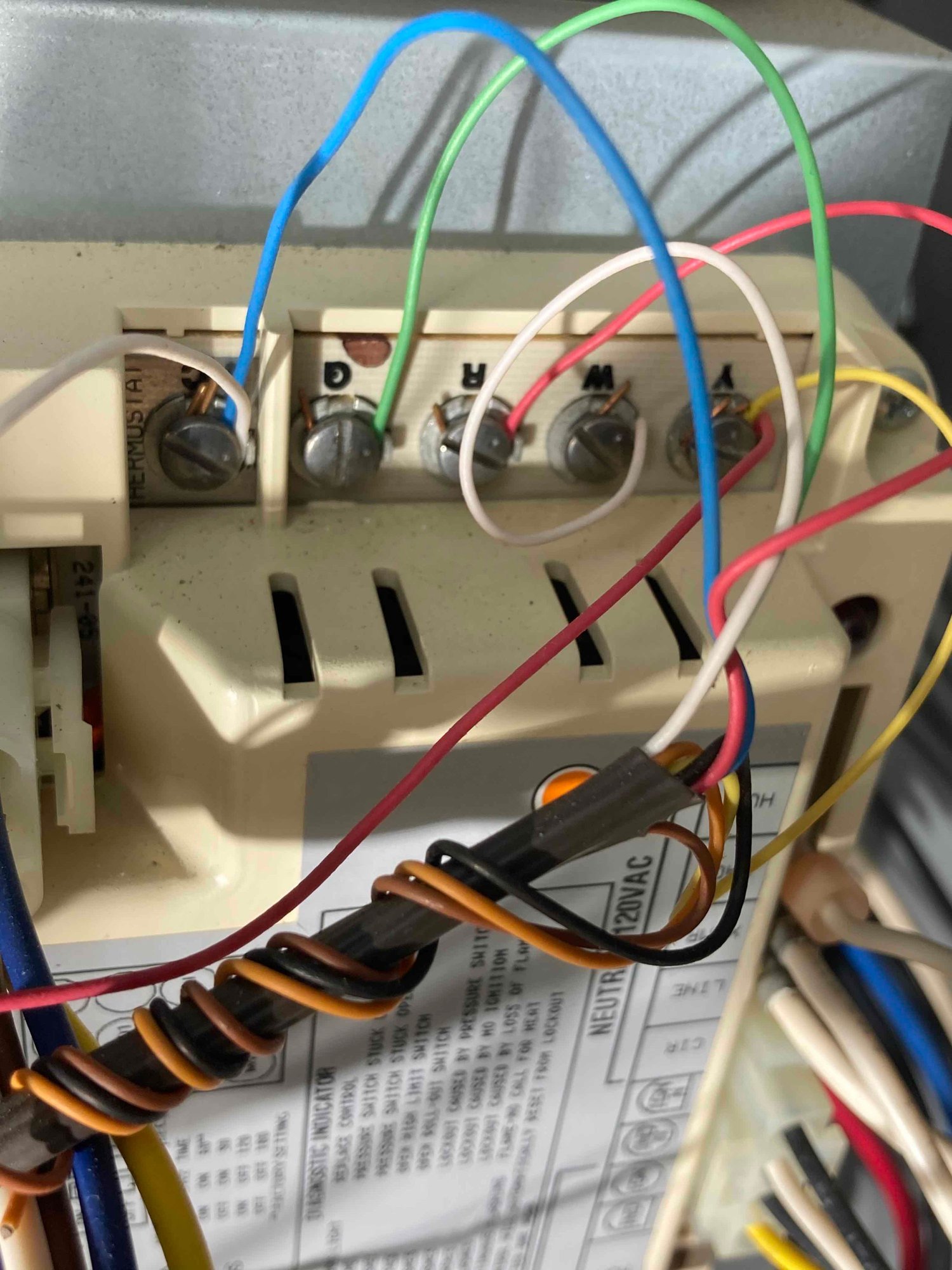

Join Date: Nov 2017
Posts: 27
Received 0 Votes
Hi PJMax,
Thanks for the suggestion, I didn't noticed the troubleshooting LED is ON or FLASHING, but I will make sure I check next time when I go up to the attic. Currently I am doing a test by removing the Green(G) cable from the control board:
************* Before disconnecting the Green cable ( see the attached picture#1 )*************
10/12, SYSTEM=OFF, FAN=AUTO:
I heard the very short(<1 second) buzzing sound(not sure if "buzzing" is the right word, but the sound was just like a motor tried to start but immediately stop, or like the sound when sump pump starts) from the attic, where the furnace is located, for about 5~7 times a day(mostly in the early morning or late evening as I noticed, but I still couldn't find the pattern), it sounded to me it tried to start the motor for 2~3 times within a half minute period, then stopped trying. This has been an ongoing issue for several weeks.
10/13 morning, SYSTEM=HEAT, FAN=AUTO:
My wife turned the HEAT on, after reaching the target temperature, the FAN kept running, while the air blew out no longer warm, so I assumed the furnace turned the fire off. I waited for >40 minutes, the FAN was still running. Then I forced to set SYSTEM=OFF. After about 5~6 minutes, the fan finally stopped.
************** Afterdisconnecting the Green cable ( see the attached picture#2 )*************
10/13 noon, I went up to the attic, disconnected the Green cable from the board, and left SYSTEM=OFF, FAN=AUTO
It has been more than 24 hours since I disconnected the Green cable(and kept SYSTEM=OFF), I haven't heard any sound from the attic yet, but I will wait for another two days.
When I was at the attic, I noticed another Green cable detached, I am not sure what's that for. I attached the picture below, can you advice?
Also, I want to mention again another test I did before(which I mentioned in my original post by following the Pepco staff's advice): I disconnected the front part of the thermostat(the main part of the thermostat, with circuit board, LED screen and control buttons…) from the wall part(where the color cables are connected), the problem persisted: either the fan ran for 30+ minutes then stopped, or I heard the short(<1 second) buzzing/starting sound from the attic.
So I don't think the problem is because of a bad thermostat control board, but I don't know about if something went bad with the connector part of the thermostat, or something wrong with the green cable(from the thermostat to the control board in the attic…
The symptom of the problem sounds to me like this: when SYSTEM=OFF or (SYSTEM=ON but FAN shouldn't be running), the fan tries to start(when I could hear those short buzzing sounds), when it fails to start, it may try again hours later. When it can successfully start, it runs for 30~40 minutes then stops)
Thanks!!

That three wire cable you identified comes from the outside condenser.
It only requires two wires..... red and white... the green is a spare.
Ok...just to clarify. You said you removed the green wire from the control module and the blower did not come at all or when it wasn't supposed to. You also said that when the wire is connected to the module and the thermostat is removed from the base.... the blower runs randomly. Is this correct ?
That would indicate a defective thermostat sub base or a shorting wire. Shorting wire is pretty rare.

So you've eliminated the thermostat. That leaves a problem wire.
Try switching from the green wire to one of the spares at both ends.

You have a York gas furnace. The control board controls the blower in heat mode.
The G/green wire is for the A/C blower and FAN ON mode.
You can leave the G wire off and the furnace will operate in heat mode correctly.

New update for my latest test:
I disconnected the Green cable from the "G" terminal on the furnace control board(50A50-241 White Rodgers), while I didn't change any connection from the thermostat end, but set SYSTEM=HEAT on 10/16, since then the system has been working well as expected for more than a day, that is, the fan ran when the furnace started heating, then stopped within one minute after the room temperature reached the target number, repeated for a few times through the day to warm up the house, that's a good sign; also I have no longer heard any weird random/intermittent, short sound from the attic(the sound might indicate the fan tried to start but failed within one second, even I previously set SYSTEM=OFF, FAN=AUTO).
I will leave the Green cable disconnect and observe for another few days, considering I learned that I don't need the G cable for heating for the winter so no risk to set SYSTEM=HEAT without the Green cable connected. If everything looks back normal after a few days, then I think both the furnace control board and the thermostat control board are NOT bad(correct me if I was wrong), the problem could be on the Green cable, or its connection to the thermostat(something wrong with the thermostat wall base, where all the color wires are connected), or its connection to the furnace control board. I have 3 spare cables to replace the Green cable.
I will post another update early next week.
Many thanks everyone!
