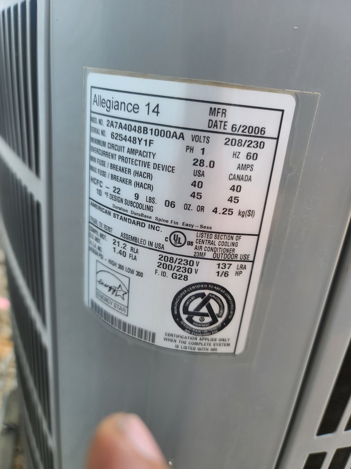

I recently bought a house and I am relocating my air conditioner condenser to the side of the home(currently in back).
I don't think the existing setup is correct, I want to avoid repeating a mistake when I move it to the new location.
My existing electrical setup, it is as follows:
- [Not OK] 60amp Breaker (I think this should be a 40amp)
- [OK] 60amp Disconnect w/40 amp fuses installed (the amperage rating for a disconnect is the MAX so using lower rated fuses is OK)
I think this is incorrect as my AC Condenser Unit label (see picture) clearly states a range of 40-45amp for fuse/breaker

So what's the problem ?
You're protecting the condenser at 40A as specified.
A/C Condenser Unit label clearly states a range of 40-45amp for fuse/breaker

Here's what happens. Many times a larger system or a system using electric heat is replaced with a smaller system requiring less current. Since the breaker is 60A...... that means you should have at least a #8 wire or more correctly... a #6 wire to the disconnect. The 60A breaker protects that wiring. The 40A fuses in the disconnect protect the condenser.
If you are installing new wiring from the A/C condenser to the panel....... you need #10 wiring and it will be on a 2P40A breaker. In this type of application.... it is allowed to use a larger breaker on a smaller gauge wire due to starting load. You can keep the fused disconnect or my recommendation is to replace it with a 60A non-fused type.
In my opinion..... and what I do..... is to use #8 wiring. That allows me to be 100% code compliant and completely safe.

Min fuse is 40 max fuse is 45. Having a larger breaker supplying the circuit and then fusing the circuit down at the unit is quite common. HAVR breakers are expensive and most contractors just go bigger and use a standard breaker. After all the breaker is there to protect the wire, not the unit. So its size is not important as long as it is larger then the min circuit requirement. Most OEM's prefer fuse protection over breaker protection. That is a subject that is complicated and is difficult to understand.
Might even be time to investigate a new system. The name plate says 21 amps for the compressor. A new one might save you a few amps in running. When I changed mine I lost 3 amps on the compressor and 15 desibles.
