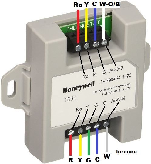

Which Honeywell are you going with? If it supports a K wire you can instead install an adapter and rearrange wires at the furnace to get a C wire. Note the K combines Y and G into one wire freeing up one for C.

It is not a problem to put two wires on the C terminal. However you don't a spare in that four wire cable. Most reliable way is to replace the cable with more wires.
Astuff mentioned using the K wire. That works on four wires.
Posting the model number will help.
A separate 24v transformer would connect to Rc and C. No R jumper.
If your stat has the R slide terminal.... set it for two R connections.

We posted at the same time. That thermostat has a K terminal which means you can use the Honeywell expander module. It requires slight re-wiring at the furnace end which is where that board goes.
Wiresaver module

That thermostat shows that it supports a K wire. Get one of the modules below and some basic wiring.
Older model: https://www.amazon.com/Honeywell-THP.../dp/B0060ASWPE
New model: https://www.amazon.com/Honeywell-CWI.../dp/B07VMV2BJ7
