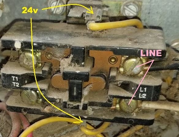

So im guessing I would have to have 240 on the black and white, L1 and L2. Where would the 24 vac come from in this picture, The yellow lead? And where are the 24 volts coming from?
The two line terminals are the 240v in to the unit.
The two 24v yellow wires get the 24v power from C and Y from the thermostat.
There will be pressure switches in the 24v lines.
